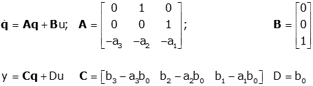

Hi,
I'm reading Ogata's Modern Control Engineering, and when he talks about the representation of a differential equation in state space he divides the method in two. The first one is when the input of the differential equation involves no derivative term, for example:
x'(t)+x(t)=u(t)
The next step is doing it with a differential equation that has inputs that have derivatives. For example:
x'(t)+x(t)=u(t)+u'(t)
He then mention that the state varibles will be
x1=y-β0u
x2=y'-β1u-β0u' and so on...
I've tried finding a reason for this and the nearest I've come is the following PDF, which has errors:
http://www.ece.rutgers.edu/~gajic/psfiles/canonicalforms.pdf
Anybody got an idea how that can be derived?
note: this is not mine...
http://lpsa.swarthmore.edu/Representations/SysRepTransformations/TF2SS.html

From these results we can easily form the state space model:
State-space model equations: q-dot = Aq + Bu with A a 3x3 companion matrix (rows 0 1 0; 0 0 1; -a3 -a2 -a1) and B = column vector (0, 0, 1); y = Cq + Du with C = [b3 - a3b0, b2 - a2b0, b1 - a1b0] and D = b0.
In this case, the order of the numerator of the transfer function was less than that of the denominator. If they are equal, the process is somewhat more complex.
