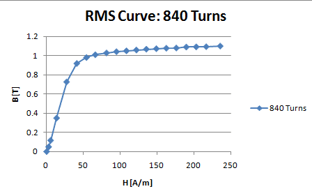

Umm, yeah, so I've got a B H curve (assuming H = NumberOfTurns*current)
and I imagine that it runs along-up the BH curve into saturation and back down again (to zero then through the negative of the curve) 50 times a second (as the supply was 50Hz). So I suppose I could take the furthest point of saturation and say it took one peak of the sine wave to get there (like half of the sin wave), which is 1 / (2*50) seconds?
Then I divide that length into a set of like 10 divisions, so steps of like 0.001 s.
Remember that I had a set of voltages and currents, would I then use only the largest current value, find it's PeakCurrent, then to find the corresponding B value is (Because graphically I don't think would be verry accurate) say:
I(t) = PeakCurrent*Sin(0.001 * t * 2 * PI * 50)
Then since I only have a finite number of voltage values get the gradient between the two points where the value of the voltage would lie between and use that to INTERPOLATE what the voltage would approximately of been, then use that to get the B(0.001t) ?
Cheers

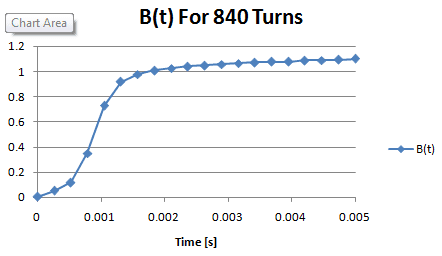

so what I was getting at is couldn't I just say I have B and H and say well the rms magnitude of H divided by 1 / (4*50) = 0.005 seconds
so it's units are A/m.s
and then if I want to take say 20 intervals, on the first interval the value of H would be H*0.00025 / 0.005 [A/m.s]
then I could just interpolate the corresponding value of B
Plot them and get a B(t) curve?
I've pondered on this further and I suppose I'm saying that when it gets to the final saturation value, when the excitation voltage was highest, the current has spiked and we've arrived at that value of B. It doesn't matter how we got there, how nonlinear the journey was, but we do know it took a quater of the voltage cycle to get there?
So you just divide up the amount of time it takes to get to a quater of the voltage cycle by how many data points you have on your curve, so the first time interval is zero and the last one is a quater of the voltage cycle, and the times should match the values of B?
What do you think, this was at 50 Hz so I just divided a quater cycle time up by the number of data points:
Or is this wrong because it implies it takes the same amount of time to get from point to data point?
I was thinking each B value would have a corrsponding Volt-seconds value, and that each Volt-seconds value I could work out the time from that??
