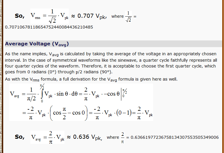

How is the average of a 100 volt Sine wave 63.6V? wouldn't it be 100/√2 = 70.7V?
And for 50Hz, wouldn't the time be 1/50 sec, not 1/100 sec?

Ok, I see how it's the 'average amplitude of half the period of a Sine wave, I always thought the RMS was the average, as I thought 'mean' was like the average. Oooh boy, you learn something new everyday... so you use RMS for power.
Could you explain what the difference is between RMS and Average? And when you use average?...I assume you use average in working out the V.s, not the Rms, for a start...
mathematically I remember it was the averages squared, then square rooted, but that still seems like the same thing...
Gee wizz...
So 100V * 2 / PI * 1/50 = 1.273 V.s

"Measuring average voltage is cheaper than measuring RMS voltage however, and that's what cheaper DMMs do. They presume the signal is a sine wave, measure the rectified average and multiply the result by 1.11 (0.71/0.64) to get the RMS value. But the factor 1.11 is only valid for sinewaves. For other signals the ratio will be different. That ratio got a name: it's called the signal's form factor. For a 10 % duty cycle PWM signal the form factor will be 1/10−−√, or about 0.316. That's a lot less than the sine's 1.11. DMMs which are not "True RMS" will give large errors for non-sinusoidal waveforms."
Ok so the difference between average and RMS really is just order of operations to get RMS from average. And we use RMS instead of average because power is propertional to voltage squared...I only sort of get that last bit.

So to calculate average power i must use average of the squares of instantaneous voltages, and square root of that is RMS
to calculate average voltage i use just the average of the not-squared instantaneous voltages , no squares or square roots at all.
