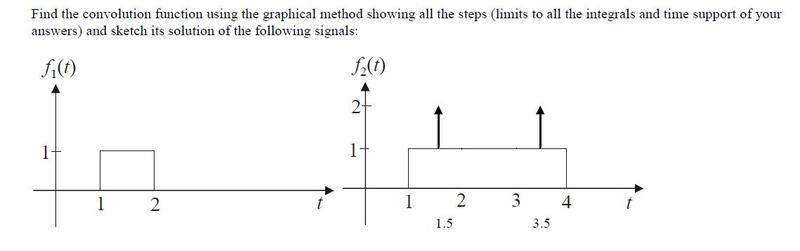

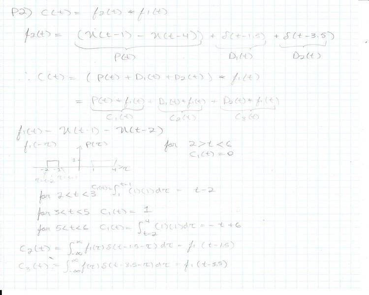

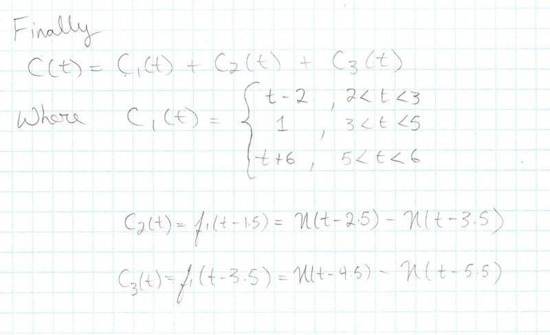

See the 2 figures attached below.
Am I doing this correctly? Is the result I obtained correct? Is there a easier way I could've solved this problem?
Thanks again!

Bump, still looking to get my work checked over.
