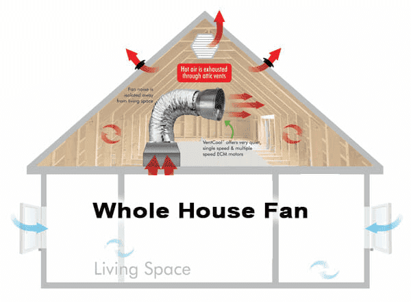

Are you familiar with "Whole-House Fans"? They are mounted in your ceiling or attic to exhaust hot air at night, and you open your windows to draw in cool air. They are more economical than air conditioning, usually, and much easier to install. Depending on the size of the electric fan motor, they may need their own dedicated electrical feed and breaker -- check your local building codes.
So one possibility is to install an exhaust fan in the skylight for the summer months and turn it on at night and open your windows. How close is your ceiling fan to the skylight?

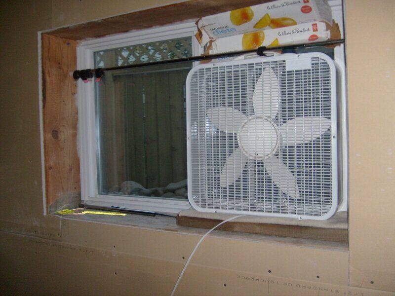

Alternatively, it may be cheaper/easier to put the fan where the air comes in:
(In this case, the basement.)
http://redhawkelectric.net/wp-content/uploads/2017/08/whole-house-fan-illustration3.jpg
I never really knew the name but I'm aware of the concept. Actually, before I created this thread. I thought several times to myself if there was a quick way to replace all of the air in the house with the outside cool evening air, that would be way more efficient than an air conditioner. I even went as far as to thinking of having a jet engine suck all the air out of the house quickly so cool air from the outside would flow in (though on a serious note, that wouldn't be very efficient and probably not safe :-p even though it would be a cool sight to behold). I'll have to look into this kind of fan more. Thanks for mentioning that.

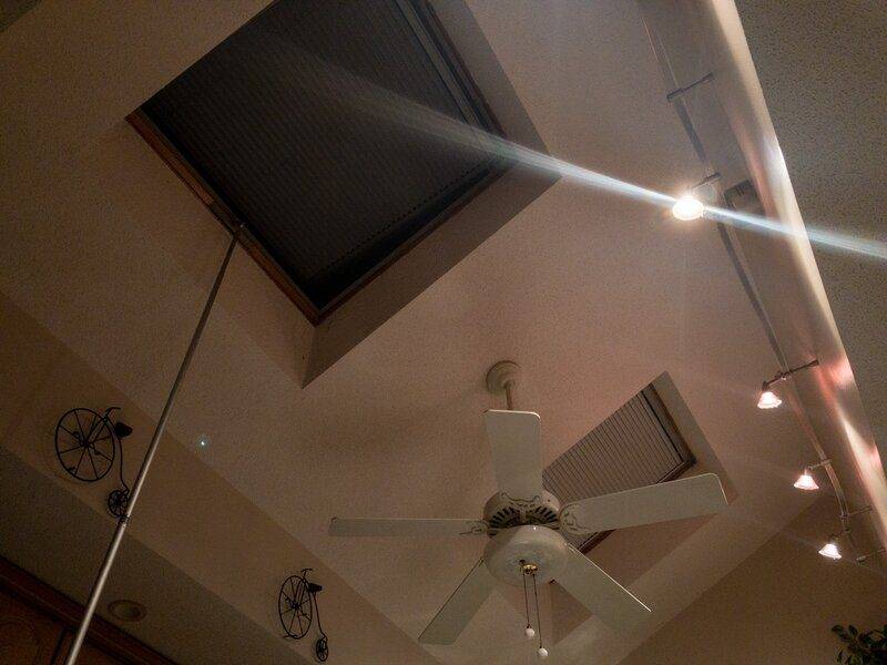

So here is a picture of the ceiling of the room I was talking about:
This is the kitchen area (should be good to use the fan during the winter at least with all of the heat coming from the appliances). Only one of the skylight windows can be opened however which is shown above.
Ha, I was actually thinking about doing this at one point. I have like 3 or 4 of those big floor fans and a couple other kinds of fans I could probably put to good uses. So far, what I have been doing was opening most of the windows upstairs and also downstairs and I can feel quite the updraft when standing at the staircase. The fans would certainly help a bit with increasing airflow around the house though not sure how much it will help versus electricity used.
