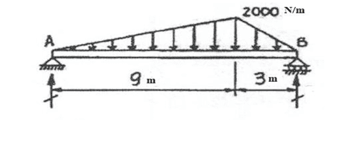

how to find distance between F to O
shear force and bending moment diagram
This is our sample problem
find shear force and bending moment diagram
after calculations supports reactions and drawing shear force diagram we have a problem ..... Distance between F to O
sHatDowN said:
Homework Statement: how to find distance between F to O
Relevant Equations: shear force and bending moment diagram
This distance because of the we need area of the 2 part of shear force diagram to draw bending moment diagram
Start from A and write the shear ##V## in the beam as a function of ##x##. What does ##V(x)## equal at the point in question? Slove for ##x##.
