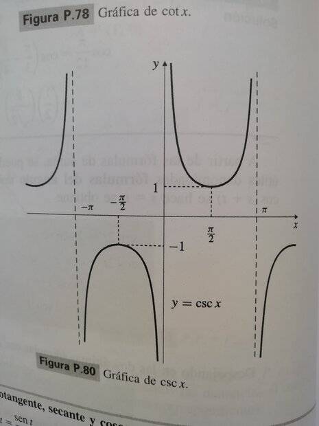

The net is very confusing; the textbooks don't make it easy. Is it right my attempt?
Hi, PF
There are two ways to write domain and range of a function: through set notation, or showing intervals.
I've chosen the set notation, and, for ##y=\csc x##, this is the attempt:
$$\text{D}:\{x\,|\,x\not\in{n\pi},\,n\not\in{\mathbb{Z}}\}$$
$$\text{R}:\{f(x)\,|\,x=\mathbb{R}\(-1,1)\}$$

You are thinking right. Only your notation has some mistakes.
For ##\mathbf{D}##, try to express it this way: you want all ##x## in ##\mathbb{R}## minus the set {##n\pi |n \in \mathbb{Z}## }
For ##\mathbf{R}##, do you want to restrict the input, ##x##, or the values of the range, ##y##? Instead of ##x = \mathbb{R}## ..., don't you want ##y \in \mathbb{R}## ...? (Of course, you can still use the dummy variable ##x## instead of ##y##, but I think that ##y## is more traditional for some people.)
Better:
##\text{D}:\{x\,|\,x \ne n\pi,\,n \in{\mathbb{Z}}\}##
##\text{R}:\{f(x)\,|\,x \in \mathbb{R} \text{\\} (-1,1)\}##

Mark44 said:
Better:
##\text{R}## is wrong. It shouldn't be ##f(x)##. It should just be ##x##.
Revised version:
##\text{D}:\{x\,|\,x \in \mathbb R, x \ne n\pi,\,n \in{\mathbb{Z}}\}##
##\text{R}:\{y\,|\,y \in \mathbb{R} \text{\\} (-1,1)\}##
