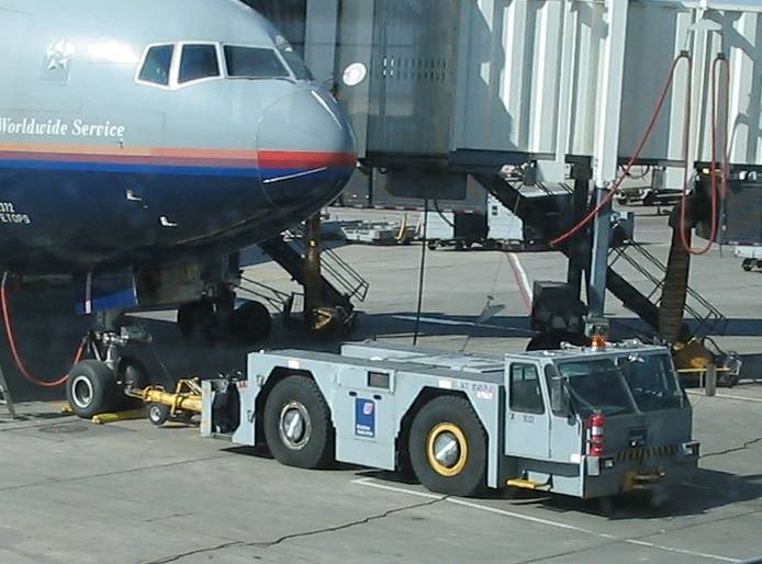

Yes - I meant running from the APU - running off is an ambiguous figure of speech... FYI - originally they wanted to use the nose wheel, did't work. As a M.E. -- can you figure out why?

Nope, think of a model of a modern airliner, apply force at the front wheel...a lot of money was spent on this before the weakness was recognized.

Since the OP has not responded, I'd guess that it has to do with not enough traction at the nosewheel to be able to move the plane (especially forward). But I'm not getting your comment about a lot of money being spent before the weakness was recognized. Can you elaborate?
BTW, Wikipedia has a pretty good article on "Pushback" procedures for airliners: http://en.wikipedia.org/wiki/Pushback
Wikipedia said:
Large aircraft cannot be moved by hand and must have a tractor or tug. Pushback tractors use a low profile design to fit under the aircraft nose. For sufficient https://www.physicsforums.com/wiki/Traction_(engineering) , the tractor must be heavy, and most models can have extra ballast added. A typical tractor for large aircraft weighs up to 54 tonnes (119,000 pounds) and has a https://www.physicsforums.com/wiki/Drawbar_(haulage) pull of 334 kN (75,000 lbf).
That tractor has much bigger wheels than the airliner
The plane is pretty balanced on the middle tires, when they tried to use the nose wheels, they would not keep traction, and if the plane was on the an incline they really had problems.

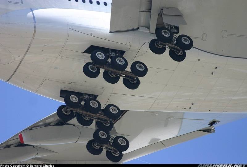

I would guess that the initial touchdown will be very unstable like you say especially for the front wheels. I'd also imagine that the huge amount of initial torque generated would be problematic to the generator and I have no idea how a conventional generator would cope with such a high and unstable force. We done a few tests on flight simulator (not sure how accurate) but after the initial touch down there is around 20-25 seconds of where the plane slows down from 140 knots to standstill. So ideally we have say 20 seconds usable time to capture the kinetic energy.
Also since we are looking at the Airbus A380, it has 22 wheels so potentially more space for experimentation, however it will be difficult to know exactly how each wheel would behave
