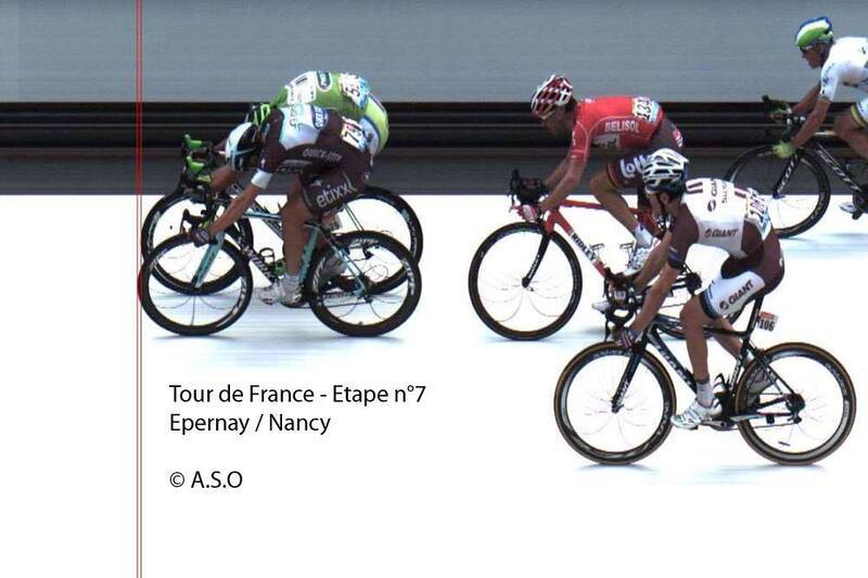

Yes the slit-camera that records an image along the finish line is automatic, but interpreting it is done by a human. The image below clearly shows the winner; the distance between the red lines represents an interval of 1/1000th of a second.
Photo capture from a Tour de France stage 7 finish, showing cyclists sprinting past the finish line with a red vertical line at the left edge and printed caption Epernay / Nancy.
Image taken from this page which has more information and interesting images from finish line slit cameras.
