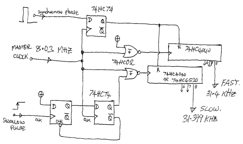

I am trying to create a phase sweeper at 31.4KHz(and constant 5V) for a small antenna array that consists 2 antennas. If I can create 2 signals with a frequency difference < 1Hz it's okay too(It will be nearly same) as long as I can control that difference because I need to change phase at a constant velocity which I can change.
It's okay too if you can tell me how to do it with arduino or LPC1769(I have one) or with a PIC(I can always buy one!). I tried to do it with arduino and created phase shifts with resolution of 5 degrees. But unfortunately the maximum frequency I got was 172Hz!

How about something like an 8.0384 MHz master oscillator feeding two 8 bit binary dividers. They divide by 256 to give 31.4 kHz square waves.
But the master clock to one of those dividers passes through a pulse swallower circuit that hides one clock pulse each time it gets a command. That swallow command can be sent 256 times per second by either a processor or a timer chip. The divider output phase will then be retarded by 360°/256 degrees per clock pulse swallowed. The divided frequencies will differ by 1 Hz. The two dividers can have a common reset to set a zero phase difference. Digital Pulse swallowing circuits are reasonably simple, usually only a couple of flip-flops and a gate or two.
You could use less bits in the dividers to get bigger phase steps per swallow.
8 bits, divide by 256, gives 1.406° per swallow. Use 8.0384 MHz clock.
7 bits, divide by 128, gives 2.812° per swallow. Use 4.0192 MHz clock.
6 bits, divide by 64, gives 5.625° per swallow. Use 2.0096 MHz clock.
Here is an untested guess at a pulse swallowing phase shift circuit.
There are three inputs. 1. The master clock. 2. A positive edge on the swallow pulse input will swallow only one clock pulse. 3. A high voltage on the synchronise phase input resets the counters to zero phase. When synchronise phase goes low the counters begin to advance together.
The 74HC4040 ripple counters should do the job OK. They could be replaced with 74HC4520 synchronous counters in applications where ripple counter phase noise is a problem.
The D-F/F used to synchronise the counter resets with the clock should not be needed for high master clock rates with small phase steps.

Thank you for your response! I am going to test it on wednesday. I'll post the results once I tested it. Also there is a symbol that I don't know on schematics. The one connected to the top pin of the top 74HC02 and to the data pin of the lower left 74HC74(a cross inside a circle). What does that represent?
That ⊕ is my shorthand for Vcc = +5V = logic high. There is an error, where the unusual Vcc is on the 74HC02 NOR gate, the unused terminal should be connected to ground, not Vcc. I was asleep when I drew the diagram and must have been dreaming of AND gates.
If the 8.0384 MHz clock is divided by 2^15 it gives ( 8038400 / 32768 ) = 245.3125 Hz. So if you extend the 'fast' output divider by a few binary stages, to generate 245.3125 Hz, then you can use that to feed the swallow control. That will give you close to a 1 Hz difference frequency.
Baluncore said:
There is something that I'm wondering. 74HC74's Q' pin connected to the other 74HC74's CLR but then doesn't Q' always become high no matter what? Even if there is a pulse swallow signal, neither Q will be high. Am I thinking wrong?
Edit: I just made a simulation in proteus and it worked. Can you explain me why? Also circuit works pretty well!(in simulation) Thank you very much! You are a lifesaver.
The first D-F/F takes the asynchronous positive edge of the swallow command and holds it until the second D-F/F synchronises it with the master clock. The duty cycle of the swallow command input is irrelevant, only the positive edge is important.
Follow the swallow logic round the loop this way;
1. The positive edge of the swallow command loads the first D-F/F with D1 which is always tied high, so then Q1 goes high.
2. The next master clock pulse transfers that Q1=high into the second D-F/F so Q2 goes high and blocks the flow of the master clock through the NOR to the 74HC4040 counter/divider 'slow channel'.
3. But that Q2=high means NotQ2 will be low, which is fed back to the negative logic Clear of the first D-F/F, cancelling the swallow state and preparing it for the next swallow command.
4. The next master clock transfers that low state into the second D-F/F, which ends the swallow and removes the asynchronous clear from the first D-F/F. That is why it can only swallow one clock cycle per command.
It worked perfectly! Thank you very much! I learned lots of things from that.
