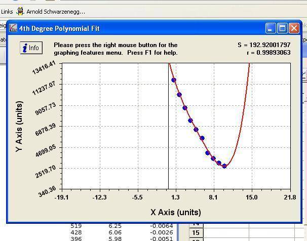

for example here is a function i fit to real radioactive decay data using curve expert.
very pretty and smooth except that it's completely wrong outside the first and last data points because the behavior is actually similar to an exponential decay function.
so what is this secret project? scheming to sell people a workout routine based on poorly motivated models and pretty graphs?
The range where the function delivers good values is the range I'll use. Otherwise I need another curve ;-)

To be fair to the OP, hasn't mentioned anything about using the function to extrapolate the data. I agree that it would be interesting to know exactly what it will be used for.

I see this all the time - curve fitting with excel etc without considering that the form of the curve needs to match the physical process being graphed. I had a guy tell me it "must be right, the R is 0.9999999 and that can't be chance..." So I plotted it out further and asked him what the big polynomial "kink" was all about...
Sorry, this is one of my pet peeves.

gmax137 is describing someone who had fit a (high-degree) polynomial to a dataset. The data fit the polynomial very closely -- the R-value (closer to 1 is a better fit), which might typically be .995, was .99999999 or so. But just because the polynomial fit those points didn't mean the polynomial fit the actual phenomenon well. gmax137 uses the example of a 'kink' in the (extrapolated?) data, which is typical of fit polynomials: they tend to 'swing around' a bit to fit the data, and outside of the particular points you chose they may not fit well.
Thanks for explaining, CRGreathouse. More clearly, data guesses are much better if a point within the extreme range are tried; outside the range - risky.
Yes, CRGreathouse's reply clarifies what I was trying to describe. I'm sorry it I was obscure. The misunderstanding about the meaning of the "R-squared" value is what I was really trying to communicate. This value tells you how close the "predicted" values are to the given data (look up "coefficient of determination" in wikipedia). Some people (my associate included) consider a good R-squared (very close to 1.00) to mean they have selected the appropriate function to use for the curve fit. In reality, this value has no such meaning.
Now as far as my reference to the "polynomial kink" - sorry for that. If you plot out some polynomials (say x^2, then x^3, then x^4, etc) you will see that they have local maximum and minimum values (where the slope goes to zero). This is what I meant by "kink."
The ultimate point is that using a function (polynomial or otherwise) to fit data that does not follow the selected function will give erroneous results outside the range of the data used to make the fit - no matter how good the R-squared value is. And the erroneous results can be wildly off, even if you are extrapolating just a little bit beyond the range.

Yes, and even interpolation can be wildly off if the degree of the polynomial is too close to the number of data points. You can get wild swings as the polynomial tries to hit everything.
