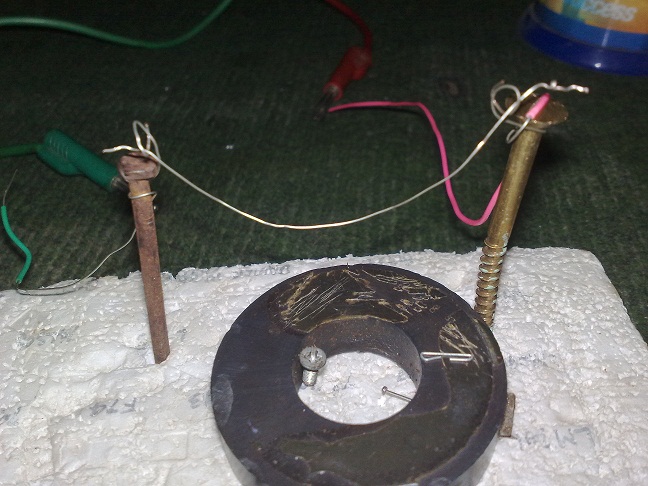

To prove my concept, I tried to do this quick and dirty experiment, but it failed.
By failed do you mean there was no observable movement? What is the material in that catenary? It looks a lot like polycarbonate string. :confused:

The setup I tried earlier was having the whole thing in series, without a lamp to reduce current, which was probably 2 amperes. The volt meter showed only 9vdc coming from the battery charger. But I should be using something else. The car charger was explained to have a rectifier that was making short jumps of current. Cutting to the chase, the small 1/16th copper wires leading form the sides of my motor melted and I was not surprised.
The eggbeater is shown on page 1 I think. It is only one continuous line of 5/64 inch copper wire.
I know there is a way to make this work. I was able ot get a similar design of smaller scale to work. SO why wouldn't this?

One word; Homopolar motor. Actually that is two words, non the less it might be a good/better solution than your design, because you don't need a commutator. Google it.
You also might want to skip the car battery, it gives a pretty nasty arc if its shorted. And can result in injury. Since it just going to rotate in free air without any loading, for a short time, regular (D-cell, 9V, 4.5V etc) batteries would be sufficient.
