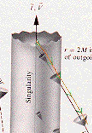

Reading "Exploring Black Holes" I find that a particle following a geodesic towards a black hole always reaches the speed of light c when crossing the "event horizon" regardless of the reduced circumference that the particle begins at (1mm or 10 million light years).
This would also apparently happen to a particle which has appeared out of the "quantum foam" where its anti-particle manages to escape (the basis of the so-called "Hawking Radiation")
Is this correct? (I have a supplementary question if this is so)

The result of all that is that when R=2M, the velocity v=-1 (ie the speed of light, c, in natural units in the opposite direction to R)
So does that mean we accept that infalling particles that follow geodesics get to the speed of light at the event horizon of a black hole?

Very loosely, and I wouldn't say that. There is no shell observer at "r = 2M". A more precise statement (echoing bcrowell) is that as r approaches 2M, the relative speed between the infalling observer and the shell observer *approaches* the speed of light.
Note that it is possible to have two different observers coincident at an event on the event horizon, but, even in this case, the relative speed between the observers is always less than the speed of light.

There is a distinction between coordinate speed and physical speed. Physical speed can only be measured locally. Let any observer measure the speed of a photon that whizzes by in his local neighbourhood. The answer is the same (the speed of light) for all observers, above, at, or below the event horizon. Also, the measured speed (again by an observer above, at, or below the event horizon) of any matter in a local neighbourhood will also be less than this speed.
This shows that there is a fundamental physical difference between massive and massless particles.

Look at the trajectory of infalling particle. Look at the point where it crosses the horizon. look at the lighcone. Now rotate the picture clockwise so the lightcone becomes vertical. This is falling observer perspective.
"the Schwarzschild metric for both space and time shows that spacelike and timelike separations are IMAGINARY"
This is wrong! It is just a ROTATION! So time becomes spacelike (in the coordinates of the distant observer) and one of the space coordinates becomes timelike (this part you are probably missing) but for the observer itself everything looks normal, again, just rotate the picture.
  • #46
Look at the infalling particle. I added red line - a path of another particle, say, another side of a spaceship. Initially they are spacially separated. Both particles are mutually inside the lightcones of each other, so they can 'see' each other (green lines).
Always - except the very final moments close to the singularity. Note that lightcones becomes narrower and narrower, it is a result of increasing tidal forces inside. At some point they look causial contact.
Timelike is NOT vertical, and spatial IS NOT horizontal. Time (for the freefalling observer) is in the middle of the lightcone.
