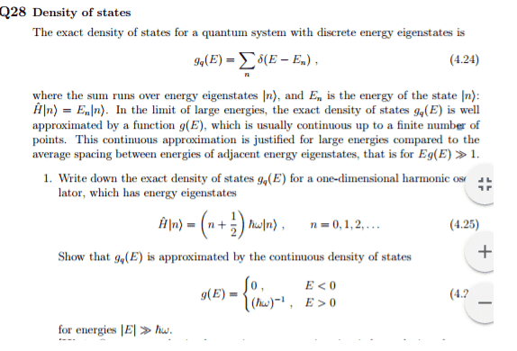

Cts approximation, delta function integration, stat mech
binbagsss
1,291
Typeset page titled Density of states, showing equation 4.24 for g_q(E) as a sum of delta functions, and equation 4.25 for the harmonic oscillator energy eigenvalues, plus a piecewise definition of g(E) with a cutoff at E = 0.
So cts approx holds because ##\frac{E}{\bar{h}\omega}>>1##
So
##\sum\limits^{\infty}_{n=0}\delta(E-(n+1/2)\bar{h} \omega) \approx \int\limits^{\infty}_{0} dx \delta(E-(x+1/2)\bar{h}\omega) ##
Now if I do a substitution ##x'=x\bar{h}\omega## to loose the ##\bar{h}\omega## multiplying the ##x## , ##dx'=\bar{h}\omega dx##
I get
## dx' \frac{1}{\bar{h}\omega}\int\limits^{\infty}_{0}\delta(x'-(E-\frac{1}{2}\bar{h}\omega)) ##
Now, if I denote the region that ##x'## is integrated over by ##D## I get that this is:
##= \frac{1}{\bar{h}\omega} ## if ##x'=E-1/2\bar{h}\omega \in D##
##= 0 ## if ##x'=E-1/2\bar{h}\omega \notin D##

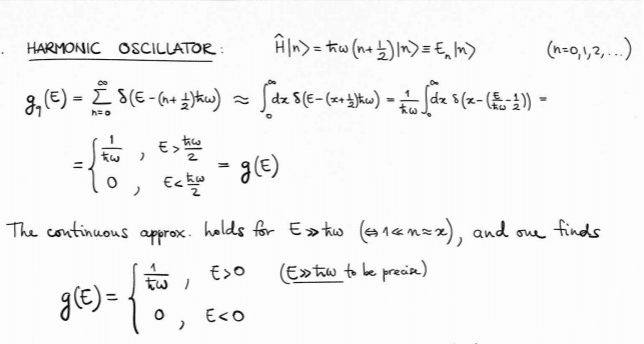

The solution however has:
Handwritten derivation for the harmonic oscillator density of states g(E): a sum of delta functions over n is replaced by an integral, giving 1/(hbar omega) for E > hbar omega/2 and 0 otherwise, then the continuous result g(E) = 1/(hbar omega) for E > 0.
##= \frac{1}{\bar{h}\omega} ## if ##E>1/2\bar{h}\omega ##
##= 0 ## if ##E<1/2\bar{h}\omega ##
Excuse me if I'm being stupid but I have no idea how we have converted the requirements of a certain value of ##x'## to lie inside the region of integration or not, which I believe is the definition of the delta function, to inequalities imposed on ##E##?
Many thanks in advance
Don't you mean for [itex]dx'[/itex] to be inside the integral? If so, you're basically done. For any [itex]x_0[/itex],
[itex]\int_0^{\infty} \delta(x' - x_0) dx' = 0[/itex] if [itex]x_0 < 0[/itex]
[itex]\int_0^{\infty} \delta(x' - x_0) dx' = 1[/itex] if [itex]x_0 >0[/itex]
So we have the particular case [itex]x_0 = E-\frac{1}{2}\bar{h}\omega[/itex]
