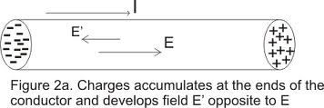

When current flows in a conductor, is it evenly spread out in the conductor? Not flowing(concentrated) in a certain part? And if we split the conductor into smaller pieces(visually not physically) the current divides out evenly so that when all those split pieces add up it equals the same as the whole piece?

When you draw electrostatic charges on a conductor, where do you normally draw them?
I went back and studied some old diagrams, of potential difference and the electric field produced on a conductor, I think... the electrostatics charge is spread out evenly on the edge of the conductor(bottom + and top - charges or vice versa), like this diagram:
Your question was about where the charges are while they are traveling as part of the current - that diagram does not tell you that.
But you have drawn the situation where there is a static charge distribution on a conductor and no applied electric field.
Where do you normally draw the charges?
Try sketching that case for a long cylinder.

We are not talking about excess free charge placed on a conductor (like a capacitor plate) which will move to the outside, the charge in a neutral (but conductive) wire is simply due to the charge carriers, and is completely neutralised over macroscopic scales by the positive ionic lattice. So you shouldn't see charge move to the outside for a simple wire due to any electrostatic effect.
However, the way those charges move is not necessarily balanced. If your wire has a kink, you will see a concentration of the current density at the inner part of the kink, like a car taking a 'racing line', because it is a path of less resistance to ground. As others have said, you also have a large concentration of current density to the outer surface with AC, which is an inductive effect.
But for a linear conductor excited by DC, the current density is indeed spread out homogeneously over any cross-section that is perpendicular to the direction of current.
