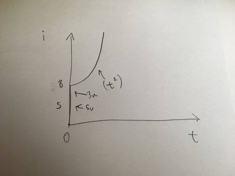

i(t)=5u(t)+ 3u(t^2)
The question is somewhat ambiguous. Does your textbook provide answers to any similar questions, because that might help figure out what they want. Their answer to question 2.7 might be enlightening.
Your sketch looks more puzzling than the question.
My instructor is actually making his own textbook for the course, so we don't have a textbook to reference to this semester. He is cutting problems out of another book and posting them in a PDF for us to work on...no clue what the book is...
Yes, we are working on Unit Step functions, ramps, and combining signals right now. I am stuck on another part because I am still learning how to use MATLAB. i(t)=u(5t)+u(3t^2)

The examples in the article all show that the expression inside the unit step's parentheses is a simple expression such as (t) or (t–4), but no multiples of t, and no powers of t.
So, for example, a ramp starting at t=0 could be described as t • U(t)
and a steeper ramp as, e.g., 10t • U(t)
If the ramp signal is described as just 10t then at times before t=0, i.e., negative time, the ramp function would have a non-zero value. But when we don't want it to be a ramp for negative time we multiply it by the Heaviside step U(t) to indicate the ramp starts at t=0, and before that it is everywhere zero.
Were we to want a signal to not appear until t=4, the unit step needed would be U(t–4).
