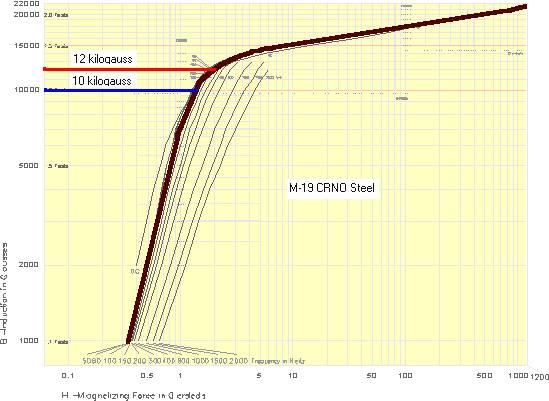

Sum of mmf's is constant , and is substantial. Power transformers operate high up the B-H curve, near the knee.
Graph of B (induction in gauss) against H (magnetizing force in oersteds) for M-19 CRNO steel, with a sharp knee, curves for several frequencies, and red and blue reference lines at 12 and 10 kilogauss.
http://commons.wikimedia.org/wiki/File:B-H_Curve.jpg

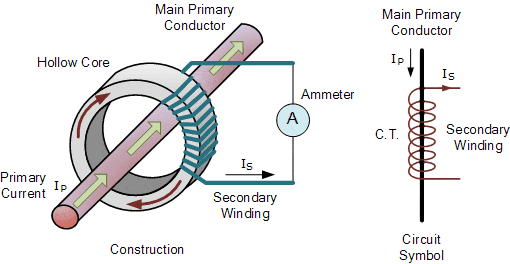

Now to the humble current transformer.
Diagram of a current transformer: a primary conductor passes through a hollow ring core wound with a secondary winding connected to an ammeter, with a circuit symbol showing the C.T. secondary winding around the main primary conductor.
Hollow refers to the donut shaped core, which is not a hollow circular shell .
The current transformer is an inductor as was the voltage transformer.
Since it goes in series with whatever device for whgich we wish to measure the current,
it is desirable to have low voltage across the CT so as to not impede current to our device.
That's true for any ammeter. How can i determine my awshing machine's current if the CT blocks current?
So we must keep flux in our CT as low as possible so it won't make any counter EMF.
Well that's easy, just short circuit the secondary.
Since the secondary mmf will cancel the primary mmf there'll be no flux to oppose primary current.

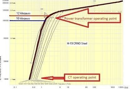

how much magnetizing current in a ct ?
Log-log graph of B-H magnetization curves for M-19 CRNO steel, with a family of curves plotted against frequency in Hz and flux density in gauss; a red line marks 12 kilogauss and a blue line marks 10 kilogauss, with red arrows labelled Power transformer operating point and CT operating point.
so our mmf's ( currents) in a CT will be more like tnis

darn lost half this post in reboot to fight the "Button Ignore War"So how much magnetizing current in a ct ?
not much. Remember we're on the bottom of the curve
and CT;s use high quality extreme permeability cores that are easily magnetized

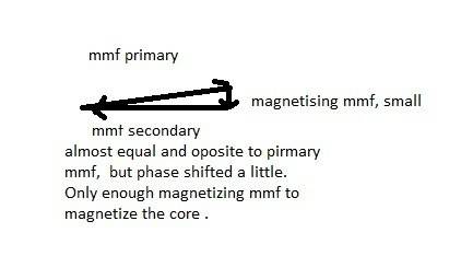

It helped me to think of primary current as two components - magnetizing and reflected from load if you will.
I use "current" and "MMF" amost interchangeably, because they're in direct proportion - hope that didnt muddy anything for you.
Hand-drawn sketch of two nearly antiparallel arrows labelled mmf primary and mmf secondary, with a small arrow labelled magnetising mmf, small, and text below saying the secondary mmf is almost equal and opposite to the primary but phase shifted a little.
So i think the answer to your original dilemma is - secondary current is 90 degrees out of phase with the magnetizing component of primary current, just as it is in the voltage transformer
but the CT consumes only a little bit of its primary current as magnetizing current, remainder shows up as secondary current.
And grade school geometry tells us that in a right triangle with such a small "opposite side", adjacent and hypotenuse are almost equal.
