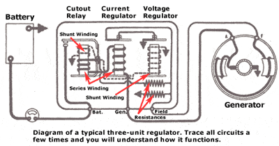

Automobile voltage regulators from 1930's through about 1965 detected the condition of "almost stops producing electricity" , see leftmost coil in this diagram:
http://www.secondchancegarage.com/public/83.cfm
When generator voltage reaches about 15 volts the voltage coil closes leftmost contact connecting the generator to the battery. Voltage coil is the "Shunt winding" drawn with a dashed line.
A current sensing coil is wound on same pole throuhg which all generator current flows. Current coil is the "Series winding" drawn with with heavy solid line.
So long as current direction is out of generator the current coil flux aids the voltage coil flux so contact stays closed.
When generator "almost stops procucing" , current reverses flowing now from battery into generator motorizing it.
So flux from current coil now opposes instead of aids flux from voltage coil and the contact will open, disconnecting battery so as to not run it down by sending current backward through generator..
Be aware skeptic is right - a DC motor/generator won't reverse its direction when it swaps from generator to motor and current reverses.
