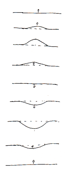

USeptim said:
A particle with [precisely] zero momenta by definition it's a plane wave on the spatial representation with zero frequency and therefore infinite wave length.
I added a word for clarification. Of course, particles with precisely zero momentum (or precisely any value of momentum) do not exist, according to the Heisenberg Uncertainty Principle.
What can exist is a wave packet whose expectation value of momentum is zero. In one-dimenisional motion, it contains waves going in the +x and -x directions, with amplitudes decreasing as you get further from p = 0. If the packet is constructed "symmetrically" so that each wave with momentum +p is "counterbalanced" with another wave with the same amplitude and momentum -p, I think you should get a wave packet that oscillates something like this (not drawn very carefully):
