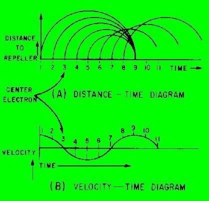

Some are accelerated and some are decelerated but how? Plzz explain sir m totally confused :( :/
According to this figure the grid provides maximum acceleration to the electrons when it is at positive peak...

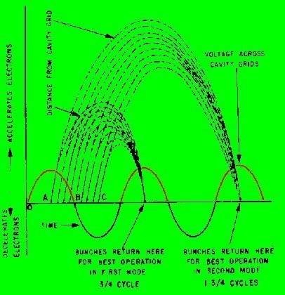

now when the beam of electrons are repelled back to grid to suffer maximum deceleration so as to release their energy to the grid ...and according to figure the electrons reached the grid when it is at the same positive peak? How it is possible? In first time the grid provides acceleration to the electrons and in second time it provide deceleration...at the same positive voltage... :/

The slowing down and speeding up effect on the electrons is due to the voltages across the gap in the resonant cavity. At resonance, the initial bunches of electrons go out to the reflector and arrive back at the cavity in the right phase for their energy to be matched back into the cavity in 'impulses.
A normal two cavity klystron is easier to understand first, where you input a signal into one cavity and an amplified signal emerges from the output cavity. In a reflex klystron, one cavity does the job of two cavities, in effect.
The main thing to understand about the way a klystron works is that the electron beam is velocity modulated, initially and then, during the time in the drift space, the electrons become bunched in waves (density modulated). Energy from the KE of the input electron beam gets transformed into RF energy and amplification takes place.
