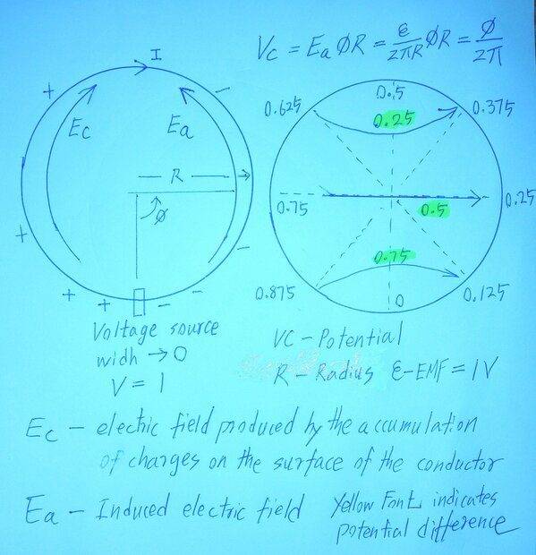

Since I marked both top and bottom as 0.25V, this already shows that the length of the resistor is assumed to be infinitely small, and the electric field inside the resistor becomes infinite, but the voltage of the resistor is still a fixed value. If I draw that resistor too small, it will be hard for people to see it.
In the example below, we can write the instant result 0.2V without solving complex voltage loop equations.
Is there any other way to find the answer so quickly without using the SPLIT FIELDS method?

I don't know, how you come to take two points and put some voltage on in it in a situation, where you have an EMF due to to a time-varying magnetic field. Due to Faraday's Law,
$$\vec{\nabla} \times \vec{E}=-\partial_t \vec{B}$$
there's no scalar potential for ##\vec{E}##, and the EMF between two points depends on how you measure it. That's well demonstrated in this (in)famous lecture by Lewin quoted somewhere above, if I remember right. All you can say is that
$$\int_C \mathrm{d} \vec{r} \cdot \vec{E}=-\dot{\Phi}=1 \text{V},$$
where ##\Phi## is the magnetic flux through an arbitrary surface with boundary ##C##. Choosing ##C## to run "along the circuit" the conclusion is that there is a current ##i## and Faraday's Law then tells you that ##I=1 \text{V}/[(0.1+0.9) \Omega]=1 \text{A}##. Which voltages you measure between any two points "on the circuit" depends on the wiring of the voltmeter you attach to the two points!

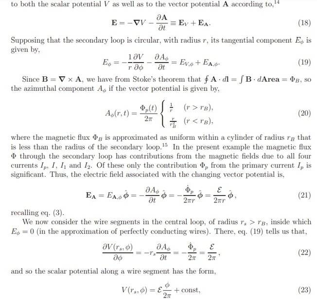

I'm not trying to describe the non-existent potential created by the induced electric field, but the scalar field created by the accumulated charge on this circuit.
As is the case in this paper http://kirkmcd.princeton.edu/examples/lewin.pdf , the same circuits are also described with potentials. Quoted below.

The following example explicitly shows the presence of a scalar field generated in the circuit.
Note that the direction of the circular induced electric field is at right angles to the direction of the wires connected to the voltmeter, so the induced electric field does not generate any emf on the wires. Now look at a plane at right angles to the ring circuit. If the voltmeter and its connecting wires are moved to any position on the plane, the displayed reading will not change, because the direction of the two wires is always at right angles to the induced electric field, so it must be measuring the potential difference generated by the accumulated charge in the circuit.
Some people may say why to complicate things, it seems that it has no practical value. But I disagree, like the above example, at least we understand what is measured and why the voltage change is measured when the wire connected to the voltmeter deviates from this plane, maybe it can be used to detect whether the plane in the mechanical structure deviates from the original position. :smile:
The last equation ##V=\epsilon \frac \phi {2 \pi}+const## is obviously false, because here V for angle zero is either undefined or experiances a leap. But any scalar potential function has to be continuous.

The last equation V=ϵϕ2π+const is obviously false, because here V for angle zero is either undefined or experiances a leap. But any scalar potential function has to be continuous.
Sorry, I really don't understand why this is going wrong. This constant means that when the angle is 0, V can be any value. This is a boundary condition and the user may decide to substitute any value.

This is true, but the problem isn't here. Assume the constant equals to zero. Angles 0 and ##2 \pi## are actually the same. At angle 0 V is 0 and at ##2 \pi## it equals to ##\epsilon##. Thus the potential is not defined. If we force V to be 0 at angle 0 anyway, then there would be a leap of this function and this is not allowed.

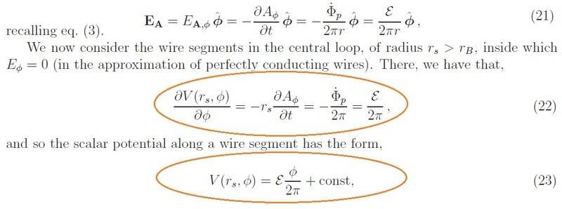

I didn't study this article carefully before, but now I understand that one of the key points is as follows.
Equation 22 describes the induced electric field strength, which is constant at every point throughout the ring, and Equation 23 describes the electric potential, whose value increases with angle. Then why it can draw the conclusion of equation 23 from equation 22. Since the electric field inside the perfectly conducting wire is zero, it must be because the electric field generated by the charges accumulated on the surface of the wire cancels the induced electric field inside the wire. Then the potential generated by the accumulated charge on the surface of the wire should also increase proportionally with the increase of the angle. This is consistent with what I've been saying. I believe it is difficult for each side to understand what the other is thinking without separately considering the electric field created by the accumulated charge on the surface of the wire.
It's described by a scalar AND a vector potential, and that must be so, because the electric field is not a conservative field in this case, due to Faraday's Law!

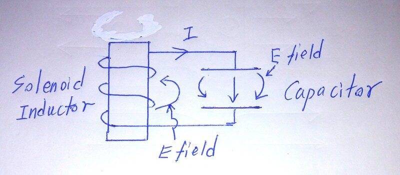

simple question. In the following system, due to the induced electric field generated by the inductance, there must be only one electric field, which is a non-conservative field.
But how could there possibly be a faster and easier way to find an approximation of this non-conservative field without separately considering the electric field generated by the charges on the two plates of the capacitor?

You just use the usual quasistationary approximations of circuit theory and Faraday's Law then leads to
$$L \dot{i}=-CQ.$$
Using ##\dot{Q}=i##, you get
$$L \ddot{Q}=-C Q \; \Rightarrow \; \ddot{Q}=-\omega^2 Q, \quad \omega=1/\sqrt{LC}$$
The solution is
$$Q(t)=c_1 \cos(\omega t) + c_2 \sin(\omega t),$$
with the integration constants ##c_1## and ##c_2## given by the initial condition, i.e., ##Q(0)=Q_0## and ##i(0)=\dot{Q}(0)=i_0##.

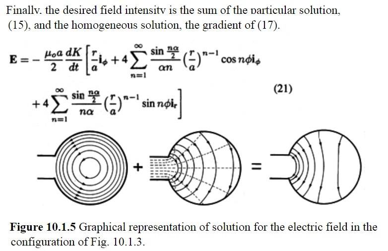

Maybe this reference would help:
https://web.mit.edu/6.013_book/www/chapter10/10.1.html
See "Example 10.1.2. Electric Field of a One-Turn Solenoid".

Thanks for the link, Example 10.12 demonstrates how to use good mathematical techniques to derive analytical solutions to physics problems.
Below I try to find potential and potential difference using the simple concept I've been talking about. It is to regard the entire cylindrical structure as a circuit to calculate. Of course, this does not have the ability to find the electric field distribution in the entire space, since Laplace's equation and other more advanced mathematics have to be used.
