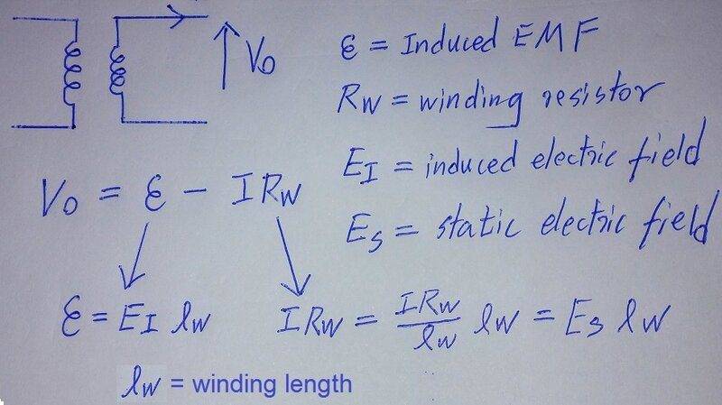

The following is an example of the out of a transformer, which also implies the concept of splitting the E field.
Handwritten notes on transformer voltage with a schematic of two coils and V0 labelled, defining EMF, winding resistor, induced and static electric fields, and winding length, with V0 = EMF - IRw.

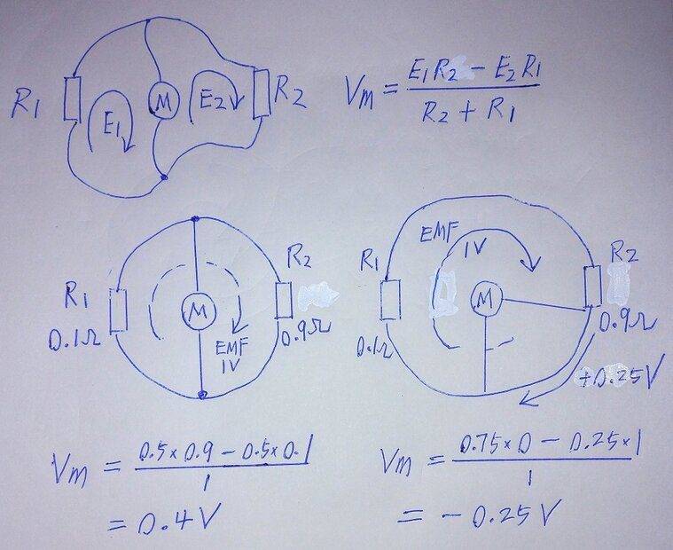

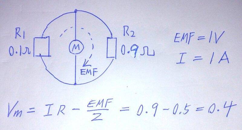

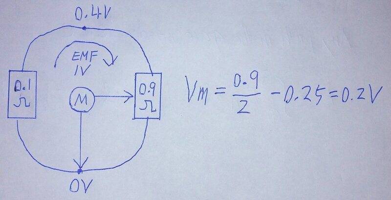

The following is a more practical example, assuming that the operating frequency is very low, and the magnetic field in the external space and wires is zero, how to find the displayed value of the voltmeter?
We can write down the voltage loop equations for the left and right sides and solve them. After a long and laborious process of derivation on at least one A4 sheet, I finally came to conclusion ##~V_m=\frac{EMF}{2}\frac{R_2-R_1}{R2+R1}=0.4V~##, but using the concept of splitting electric fields gave immediate results.
Handwritten circuit diagram of a loop with a voltmeter M at the centre, resistor R1 = 0.1 ohm on the left and R2 = 0.9 ohm on the right, EMF arrow in the loop, EMF = 1V and I = 1A, and the equation Vm = IR - EMF/2 = 0.9 - 0.5 = 0.4.
It can also be used to evaluate the distribution of charges on the circuit, which is very interesting and practical, such as the following example, I believe it is not far from reality.

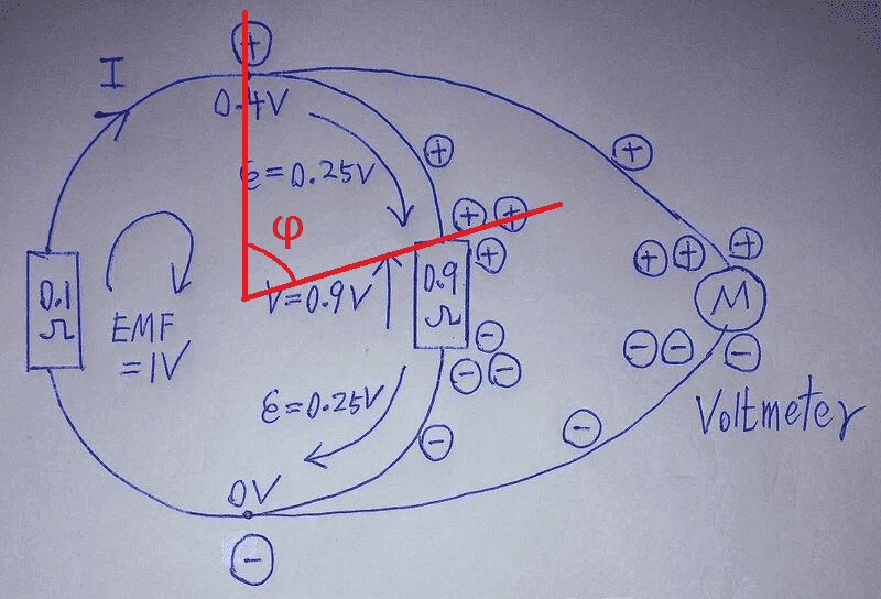

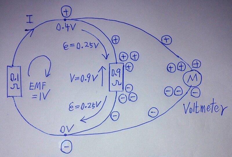

Hand-drawn circuit diagram of a loop with an EMF source labelled 1V and a 0.9V source on the right, with voltage labels 0.4V, 0V and 0.9V, field arrows labelled 0.25V, plus circled plus and minus charge signs and a voltmeter labelled M.
Please note that from the bottom 0V to the top 0.4V can be expressed as ##~-0.25+0.9+-0.25=0.4V ##

alan123hk said:
In this diagram, the source of "EMF=1V" is undefined. If lumped element model is valid here, then you have to add a power source with voltage drop on its terminals - a battary or an inductor. But if your EM system cannot be modelled with lumped elements, then all potentials at nodes (0V, 0.4V) are just invalid.
This is a sketch related to the Lewin circuit paradox, if you are not familiar with this topic, it is really hard to know what I want to express, please refer to this link http://kirkmcd.princeton.edu/examples/lewin.pdf.

SDL said:
on the 3rd diagram I can see an arrow directed CW with EMF=1V. My first question is "Where is it from?"
This EMF comes from a solenoid magnet in the center of the ring circuit, creating a time-varying circular area magnetic field. According to Faraday's law, the induced EMF on this circular circuit loop is 1V. If you've seen the link I suggested, you should know.

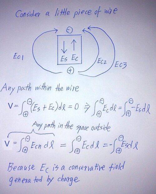

As I said, I'm calculating the potential difference and the electric field due to the accumulated charge only, so of course the closed loop integral of the electric field due to the accumulated charge alone is zero.
If the position changes (move the wire, etc.), the charge distribution will of course change, and therefore the potential, but a conservative field will still be produced.

Having disassembled a factory inductor or transformer you would be able to observe all the effects discussed above - a solenoidal electric field, a complex charge distribution compensating that field along the wire etc. And if you stretch it or deform in some other way, its properties certainly change. Google for formulas for inductor designers and you'll see that they all contain geometrical variables. But circuits are represented as graphs, which define only connections of solid elements, but not circuit geometry. That's the main difference.

Handwritten diagram of a loop circuit with resistors R1 and R2 and a voltmeter M, EMF E1 and E2 marked, with the formula Vm = (E1R2 - E2R1)/(R2+R1); below, two loop diagrams with R1 = 0.1 ohm, R2 = 0.9 ohm, EMF 1V, and worked calculations giving Vm = 0.4V and Vm = -0.25V.
First, one has to agree that your examples do not belong to those the circuit theory deals with, because KVL is not true here. Despite of it they can be modelled with lumped elements. I suppose you have been inspired by that paper about a circuit paradox or maybe by some discussions at other threads/forums. A circuit with a localized magnetic flux inside is a very special case emloyed to offer that "paradox" to public. Please explain why to continue putting effort to develop analysis of this kind of EM systems? Do you see any practical usage or just academic interest? No, I'm not going to discourage you, just want to know.
You said that this circuit does not comply with KVLl, I respect your opinion. But I think I'm using KVL to analyze it.
Whether I'm particularly interested in this circuit is beside the point. I use this circuit as an example to illustrate the application of "split Electric fields". I don't understand why many people think this method is unnecessary or not useful. I think that "split Eletric field" means considering that the electric field is a combination of two different fields Ev and Ea, and use it to help solve problems when need.
Does the article in this http://kirkmcd.princeton.edu/examples/lewin.pdf also mention using KVL and splitting E into Ev and Ea to handle the problem? Maybe it is unnecessary in advanced math models, but I think it can be useful in practice, at least for those who are not good at advanced math.
This is because the line integral of E along a closed path around the magnetic flux in this circuit is non-zero, while due to KVL it is zero. Certainly I mean the resulting E-field ("non-split").

On this diagram, there are two EMFs along two wires ##\epsilon=0.25V## each. For a perfectly conducting wire, if it neither accumulates/distributes nor dissipates energy, ##\int_A^B\mathbf{\vec{E}}\cdot \mathbf{\vec{dl}}=0## where A and B are its ends. On the other side, if you "split" the resulting field, ##0=\int_A^B\mathbf{\vec{E}}\cdot \mathbf{\vec{dl}}=\int_A^B\mathbf{\vec{E_c}}\cdot \mathbf{\vec{dl}}+\int_A^B\mathbf{\vec{E_s}}\cdot \mathbf{\vec{dl}}##. So in order to calculate voltage drop ##V_{AB}=\int_A^B\mathbf{\vec{E_c}}\cdot \mathbf{\vec{dl}}## you need to calculate ##\int_A^B\mathbf{\vec{E_s}}\cdot \mathbf{\vec{dl}}## for the solenoidal part, which depends on path from A to B, i.e. on wire geometry.
Please argue how do you calculate ##\epsilon=0.25V## for either wire? Why not ##\epsilon_1=0.3V## and ##\epsilon_2=0.2V##? What's the reason for them to be equal? Their sum is ##\epsilon_1+\epsilon_2=0.5V## in both cases, so not breaking the total EMF=1V.
SDL said:
Please argue how do you calculate ϵ=0.25V for either wire? Why not ϵ1=0.3V and ϵ2=0.2V? What's the reason for them to be equal? Their sum is ϵ1+ϵ2=0.5V in both cases, so not breaking the total EMF=1V.
This is a logical reasoning process.
Since the EMF for the entire loop is 1V, the EMF for a quarter of the loop length is 0.25V. Since the charge accumulating on the surface of the wire must produce the same Ec to cancel out Es to make the total E inside the wire zero, the corresponding potential difference over the length of this loop is also 0.25V.
So I don't actually need to use such a complicated calculation method to find 0.25V in post 22. But we can also use it as a validation method.:smile:
If we subtract the solenoidal part, the conserative remainder would have well-observed voltage drops.

Handwritten derivation: a piece of wire with a + and - charge at its ends, field labels Es, Ec, Ec1, Ec2, Ec3, and integrals of E-fields along paths inside and outside the wire.
After the charge accumulated on the surface of the wire cancels the induced electric field inside the wire, it will not weaken the potential difference it exhibits to the outer space
What I asked you to prove is why the EMFs along the two wires are the same and equal to 0.25V. That is to provide calculations instead of "locical reasoning". Can you solve your own circuit using EM laws?
