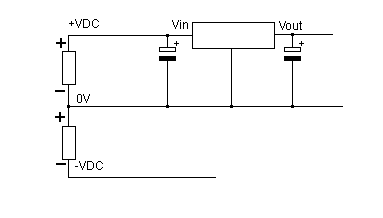

I have a device in a DC circuit that calls for decoupling capacitors on VIN and VOUT. The circuit is powered by two batteries in series. The above device is hooked up in parallel to the second battery with the device ground connected to the node shared between the two batteries like so:
Code:
|               | vin
_              00
.               00--------- +
_ vdc2       00
.                |             vout
_                |
.                 X
_ vdc1         X
.                 X
Should I connect my decoupling capacitors to the node shared by the the negative terminal of vdc2 or the node shared by the negative terminal vdc1? Does it matter? Topologically, with the real world circuit, it would be easier to connect to that bottom most node shared by the negative terminal of vdc1, but I'm not sure if having the potential of both batteries across the caps will cause bad things to happen...
Thank you!

what is the device?
what does that vertical XXX line represent ??
not really enough info and the ascii drawing doesn't really help ;)
Dave
is this more like what you are looking for ? ...
Circuit schematic of a dual-supply rail with a three-terminal block between +VDC and 0V, Vin and Vout labelled, electrolytic capacitors on the input and output, and a -VDC supply below 0V.
where the device is say a voltage regulator ?

Yes, exactly. It's just a linear regulator. Is the way you connected the decoupling caps correct? Or rather, would connecting the negative terminals of those caps to the node at the very bottom of the diagram be incorrect?
the way I connected is correct. Note also that because you are supplying the regulator from a battery then the supply is going to be very smooth anyway. Any decoupling capacitors are going to have very small values that are mainly for inhibiting any internal oscillations of the regulator chip.
Practically speaking ~ 10uF on the input and ~ 100nF (0.1uF) on the output. And preferably ensure that the capacitors are rated to at least double the voltage at that point
eg. a 10V on input to the reg. use 25V rated caps etc You would get away with 16V rated 10uF cap, I personally like a good bit of headroom ;)

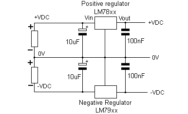

ok to take the circuit one step further ... you may want a positive and negative regulated supply, it would be done like this...
Circuit schematic of a dual-rail regulated supply: a positive regulator LM78xx and a negative regulator LM79xx, each with 10uF input capacitors and 100nF output capacitors, between +VDC, 0V and -VDC.
LM78xx could be a 7805, 7812, 7824 etc
LM79xx could be as above but the negative version

The caps were intended for oscillations, but, just out of curiosity now, would it ever be valid to couple down to that bottom node? If the caps were just there for line noise or any other kind of signal that needed to be grounded out?
edegro said:
Thanks a lot Dave. Very much appreciated.
you're welcome :)
no it would never be valid to decouple to the negative rail. You always decouple to the 0V rail in a single or 2 rail system.
Now if these regulators were fed from a transformer and a bridge rectifier then you would need additional large capacitors on the input to the regs. The general rule of thumb is 1000uF per 1A of current drawn. This is because the DC output from a bridge (or other) rectifier system is not smooth. It has a lot of AC ripple voltage present that needs to be taken care of.
cheers
Dave
NOTE just noticed a boo boo I did in that diagram
The 100nF caps on the output of the voltage regulator are NOT polarised ... will do an edit
