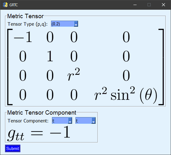

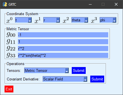

Okay sooo here is the difference between the two fonts.
Without a spesific font
with Tahoma, Georgia and Bookman
and the look is important for me.
