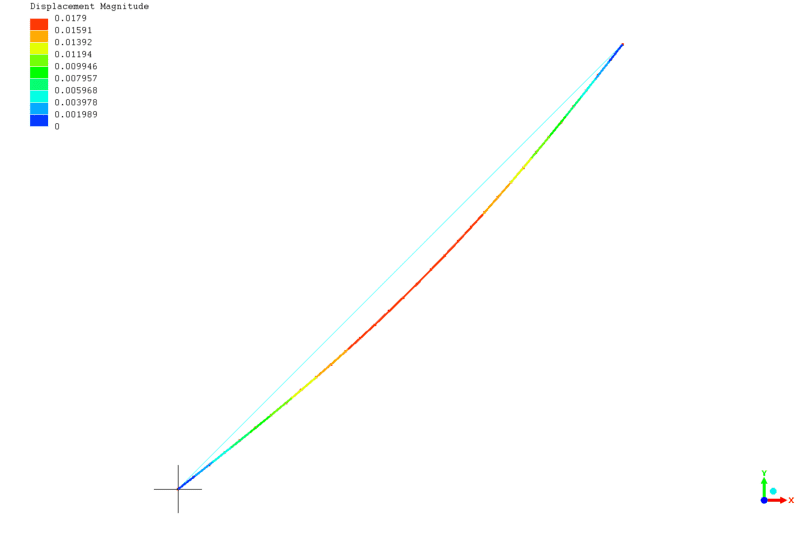

Another five minute FEA . 3 metre long rubber rope at 45 degrees to vertical . Uniformly distributed load acting vertically downwards . Linear model and magnified deflection for display .
As far as I can tell by visual inspection that curve is symmetrical . I'll have a look at the raw data later on to see if it actually is .
Interesting to see the deflection simulated. Thanks for the input. Knowing the behavior will help us al ot when solving it numerically,
