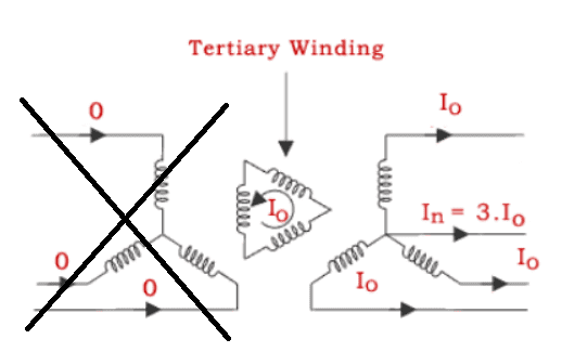

Hi again, another question.
Please see the schematic below. It shows a wye-wye(n) with a delta tertiary winding. So this delta winding is inserted here so that we can achieve amp-turn balance with the zero sequence currents flowing on the secondary side.
I know that zero sequence currents cannot flow on the primary side due to no neutral conductor. But how does the tertiary winding help us, to let zero sequence flow on the secondary? "Current must return to the source", so below the zero sequence currents are flowing between the load and secondary and gets amp-turn balanced in the tertiary, but no zero sequence currents are returning to the source?
What am I missing here?

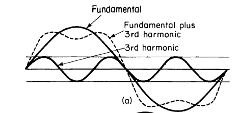

Third harmonics are in phase with one another
So on the primary wye side, write KVL around any two phases. 3rd harmonic voltage in one phase exactly cancels 3rd harmonic in the other. So no 3rd harmonic current can flow over on left side of your drawing because there's no voltage left between phases to push it. .
On secondary wye side 3rd harmonic is free to flow out the neutral.

Thanks, still I find it somewhat difficult to understand. Since the zero sequence currents can not flow in the primary i.e. there is no closed loop between load and source, why is the zero sequence current "allowed" to flow in the secondary in the first place if it can not get back to the source on the primary side?
You have to be quite literal in applying Kirchoff.
Current is charge in motion
no charge is exchanged between primary and secondary, only energy. Primary and secondary currents are in proportion because energy is conserved...
The source of all secondary current is the secondary winding.
Now, phase sequence components is not my expertise so i'll just stick with third harmonic which, if balanced, is zero sequence.
Without the tertiary winding, any secondary load that demands third harmonic current will distort the voltage wave likely 'flat-topping' it.
Tertiary (or a delta primary) gives those harmonic currents a place to amp-turn balance so the transformer can pass along energy at that frequency that's in phase in all 3 windings...

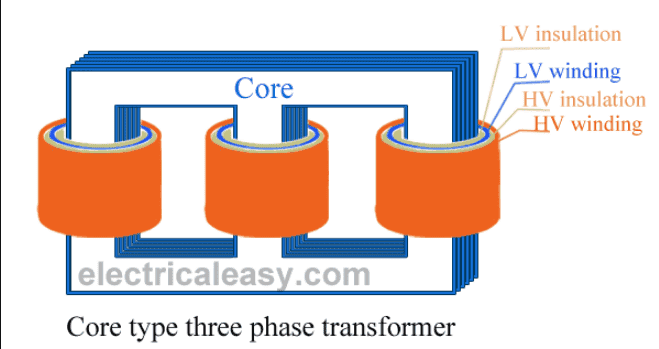

Triplens (harmonics that are multiples of 3) circulate in the delta tertiary, but do not appear in the wye primary. The amp-turns are not balanced, since triples are compon nets of magnetizing current. Magnetizing current is necessary to maintain core flux & is not balanced in other windings.
Without a delta tertiary, a wyw-wye come without a 3-legged E core (core type), with only 3 wires will exhibit triples in the core fluxes & line to neutral voltages. This places increased stress on the insulation & core flux.
By adding a delta tertiary, the triplens in the core flux have a closed path via the delta, & a circulating triplen current exists. But as soon as triplken current commences, a magnetic flux commences per LL, the law of Lenz. This flux opposes the original triplen flux.

KraakeCrest said:
Imagine you have a power system and the only load is some load causing zero sequence currents or third harmonics if you prefer, similar to my picture in my first post, no other currents are in the system.
No other currents? You mean no tertiary ?
You have postulated something that can't work. It violates Kirchoff's current law.
Here's why
Imagine three individual single phase transformers wired up as you suggest. That way there's no mixing of flux which might make a 'ghost tertiary', if you will.
Furthermore let us make their turns ratio 1::1 just for simplicity.
On primary side, each winding current must equal secondary winding current .
That defies KCL because they all three flow into the neutral.
So this transformer connection is incapable of providing only balanced zero sequence 3rd harmonic current.
What will happen is this
On primary side we have a three legged voltage divider, and neutral voltage will no longer remain stable at zero. It'll shift as required to force primary current to obey KCL, if it can.
If we back off on the requirement of only zero sequence and allow some fundamental frequency load current to also flow, 3rd can add or subtract from that and the transformer can deliver distorted load current with third harmonic content by shifting its primary side voltage division ratio . That is real and is called in the textbooks "Neutral Instability"
Of course , shifting voltage division ratio on primary side shows up as shifted voltages on secondary side too, hence the precautions against using this particular connection for a transformer. Secondary voltage becomes grossly distorted by third harmonic..
And i suspect -but do not know for sure- that what we thought was balanced zero sequence third harmonic current sprouts negative and positive sequence components. Perhaps @cabraham is better versed in that math than i.

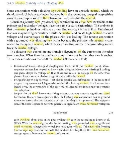

Here's an extract from a textbook describing neutral instability.
https://books.google.com/books?id=f...ad on wye winding neutral instability&f=false
sorry for the long link, google just does that.
It is very real. As usual, if the math says it's there it probably is. I've seen it with an oscilloscope so I'm a believer.
Here's that book
Any help ?

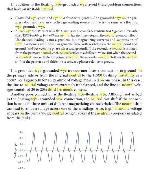

The Y-Y configuration is by far the most problematic. The 3 means of mitigating its problems are as follows.
3) least desirable - a 4th wire connecting primary neutral to generator neutral. This provides a path for zero sequence currents due to unbalanced line to neutral secondary loading, as well as triplen harmonics of the magnetizing current.
But carrying 4 wires negates the advantage offered by 3 phase systems. A 3 wire system only consumes 75% the conductor weight of other numbers of phases. The towers supporting the wires would need to be bigger as well. Use of 4 wires works for short distance runs.
2) Delta tertiary - the tertiary closed path of the delta provides a path for 0 sequence & triplens. System stays balanced with 3 wires.
1) core type windings, the use of a 3 legged dual E core suppresses 0 sequence flux & triplens. The 3 legged core acts like a delta. System stays balanced in Y-Y with just 3 wires.
In a nutshell, avoid a pure Y-Y, unless a 3 legged E core pair is used. A delta tertiary is preferred for shell type & 3 single phase cores connected for 3 phase.

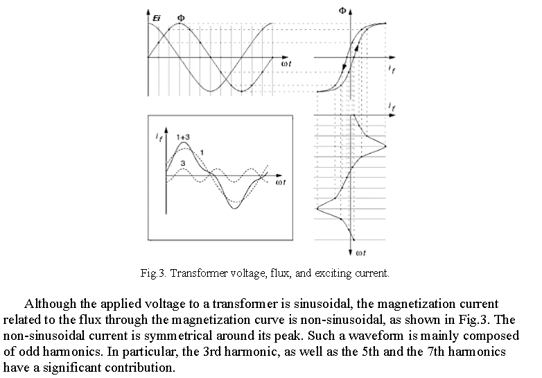

Now the latter is well known - BH curve is nonlinear so magnetizing current required to make sinusoidal flux must contain a 3rd harmonic component
and a wye with no neutral can't accept it
so the flux and hence the voltage will distort.

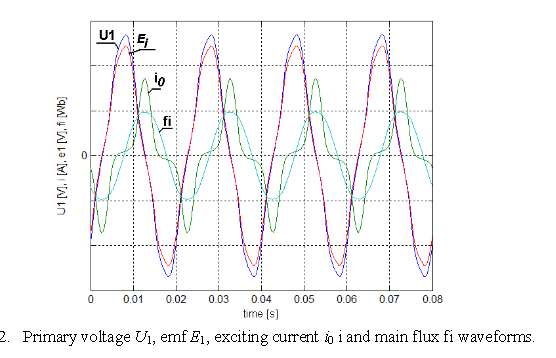

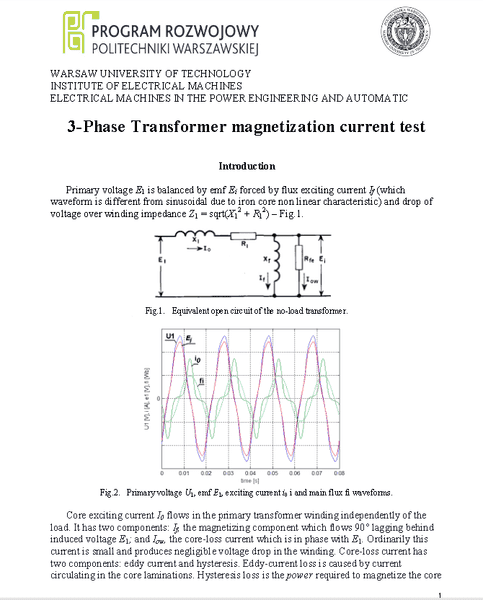

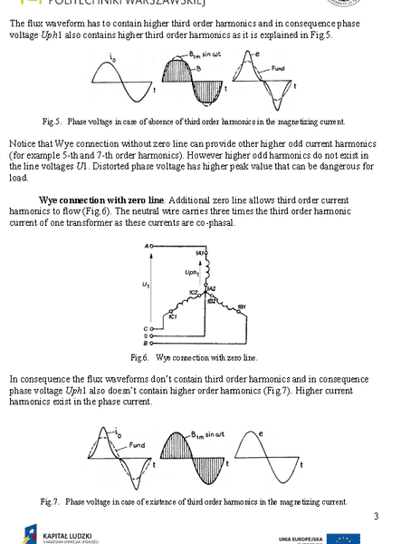

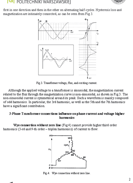

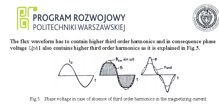

Here's a brief snip from a school lab exercise that's close to the subject, he's more concise than me.
http://www.ime.pw.edu.pl/zme/dyd/mater/emitpeaa/instr_tr.pdf
That 3 wire wye primary will have neutral instability even without a load on the transformer.
But when you add a delta tertiary you have wired in series three windings that , for 3rd harmonics are in series aiding so are a short circuit.
Natural feedback - just enough current flows in the tertiary to make individual phase primary counter-emf's a nice sine wave and neutral settles down.Any help ?

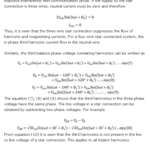

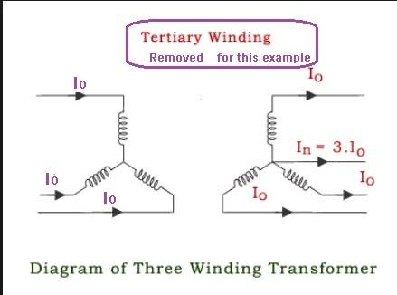

My choice of words "voltage divider" seems not ideal, and i stumbled across another site that might help me formulate a better explanation.
I am not satisfied with what I've said and will work on it tonight. Meanwhile, from this link which discusses a tangent to your question,
http://circuitglobe.com/harmonics-in-three-phase-transformers.html
He shows by algebra that third harmonic current cannot flow into a three wire wye (which he calls star).
Then he shows by algebra that the line to neutral voltages CAN contain third harmonic but without a neutral we cannot detect their presence.
5th and other non-triplens are present and detectable but we're not concerned with them...
Hmmm
so presence or absence of 3rd harmonic in line to neutral voltage cannot be detected by line to line measurement
and that means we can't tell from primary side line to line voltages whether they are present.
Even in absence of third harmonic current entering your transformer, each line to neutral voltage can contain a third harmonic.
But it won't show up in the line to line voltage. (I know I'm repeating - i do it for myself when proofreading for consistency)
It will show up as neutral displacement, because at any instant the third harmonic component adds to one (or two) of the phases and subtracts from the other(s)

Now, adding a delta winding short circuits third harmonic component of phase voltages as i mentioned above.
Any third harmonic component of flux will induce current in those delta windings that, by Lenz's Law, opposes said third harmonic flux. That component of flux will be driven to almost zero, just as in any short circuited transformer.
>>>>It's very backward to our intuition though to think of third harmonic flux as driven not by a third harmonic component of primary current but instead by the LACK of one. <<<<
I think that's the thought key i was looking for.
Probably i should have started there, with BH curve That's what underlies the blue oops- edit - make that dark green i0 magnetizing current's peakiness in that Warsaw University lab exercise up above
If those mostly 3rd harmonic magnetizing current peaks can't flow , the flux and voltage won't be sinewaves.
Then we get into the three phase trigonometry that hides that distortion from you when looking line to line.

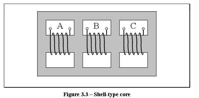

@jim hardy , quick follow-up questions if you don't mind? When you said:
This could be a three-limb transformer core, as shown in the picture below. And the reason for it to act as a "ghost tertiary" is because of the high reluctance path of zero sequence flux (through the transformer case e.q.), and a high reluctance path for zero sequence, results in a low impedance for zero sequence components, right?
I was thinking more about the transformer's operation with no tertiary.
So i added the condition to our thought experiment of 'separate transformers'
just to rule out a return path for 3rd harmonic flux
and that's what i meant by "Ghost Tertiary " ..
But yes, i think you're right.

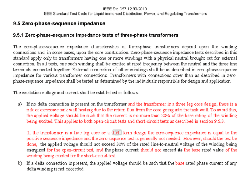

The 3 limb can't oppose zero sequence voltage very well and that's why they caution in the IEEE test below (that Google found for me, )
when applying zero sequence voltage you must limit current to 20% of rated.
It's current that makes flux and they're keeping the iron transformer case safe with an ammeter on the exciting winding.
You've been around, haven't you ? I would learn a lot working with you. That was the fun of a maintenance career - everybody i met taught me something.
For non power folks
When we just say "three phase transformer" we aren't specifying what kind of magnetics it has, "Core" or "Shell" .
The shell type has EDIT lower HIGHER zero sequence impedance because there's a return path for zero sequence flux. It's Flux that makes counter-emf and opposes flow of current
(Thanks @KraakeCrest for catching that blooper)
from http://www.electricaleasy.com/2014/04/three-phase-transformer.html
From an IEEE test standard : http://grouper.ieee.org/groups/transformers/subcommittees/performance/TF_C57_12_90/S13-C57.12.90%20section%209.5%20zero%20seq%20with%20mods.pdf

jim hardy said:
The shell type has lower zero sequence impedance because there's a return path for zero sequence flux.
Hmm, should it not be: Has a higher zero sequence impedance, as there is a low reluctance path in the transformer core as impedance is proportional to 1/reluctance.
You are exactly right - my mild dyslexia at it again. Will fix the post now. THANKS !.
KraakeCrest said:
I wonder what the pros of using a four limb three phase transformer core would be,
ooops should have said shell core
