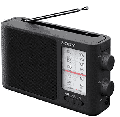

nauman said:
Are not there any commercially available AM demodulators with analog output which can do this task?
But seriously, tuned narrow-band ones, sure. Able to find a random signal over the broad frequency range you are specifying in the presence of other signals, not so much. That is probably why the SDR was suggested...
