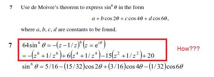

Can somebody explain to me how the first two steps are performed?
I have no idea how to start the question. I tried using an equation for sin^6 x derived by (cos x + i sinx)^6 = cos 6x+isin 6x but the solution becomes way too hard.

If [itex]z = e^{i\theta}[/itex] then [tex] \cos n\theta = \frac{z^n + z^{-n}}{2} \\<br /> \sin n\theta = \frac{z^n - z^{-n}}{2i}.[/tex] Hence [tex] \sin^6 \theta = \frac{(z - z^{-1})^6}{(2i)^6} = -\frac{(z - z^{-1})^6}{64}.[/tex]
Are these equation correct?
[tex]\sin^n \theta = \frac{(z-z^{-1})^n}{(2i)^n}[/tex] and [tex]\cos^n \theta = \frac{(z+z^{-1})^n}{2^n}[/tex]
Yes.
