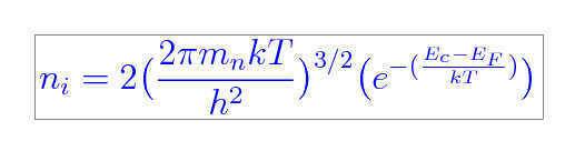

I am following a lecture on carrier concentration and I got to the point where the instructor said that for homework, derive the carrier concentration equation ni, which equals:https://www.physicsforums.com/attachments/81076

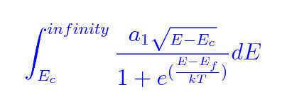

To derive ni you need to compute the following integral which I am having trouble solving:

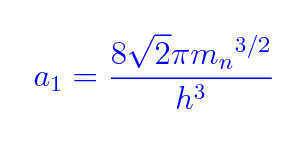

where:
I tried Integration by parts and no luck. Any help would be greatly appreciated.

90make the variable change assume X = (E-[E][/C]/kT)
