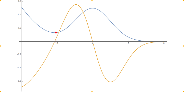

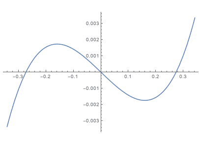

Plotted what should be an analytic function, as a function of real and imaginary part. The slopes are different. Why?
Below are plots of the function ##e^{0.25(x-3)^{-2}} - 0.87 e^{(x-3.5)^{-2}}##
The first plot is for real values. It has a minimum at the red dot. The second plot has in its argument the same real part as the red dot, but has the imaginary part changing from -0.3 to 0.3. It shows the resulting change in the imaginary part of f(z).
For an analytic function (which I believe this one is) the derivatives around any point should be the same, approaching a point from the real and complex directions, but here obviously they are not. What have I got wrong?

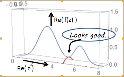

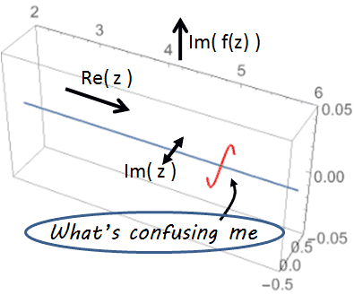

Thanks for the responses. What I am trying to do is to eyeball the plots of Re( f(z) ) and I am ( f(z) ) as a function of z, and visually compare the slopes for real ##\Delta z## and imaginary ##\Delta z## around a point of interest. This comparison should be particularly easy at a min/max of the real part, where ##Re(\Delta f)## and ##Im(\Delta f)## are both zero.
My problem is with the plot of Im( f(z) ), where the ##\Delta f## is zero for real ##\Delta z## but non-zero for complex ##\Delta z## (or so it seems to me).
Here are 3D plots of the real and imaginary parts, with the changes from the point of interest shown along the real and imaginary directions (light blue and red respectively). The slope of the red curve in the second plot (imaginary part of f) is obviously different from the slope of the light blue one -- which is the cause of my confusion.

Given that, in your first post your first plot is clearly ##u(x,0)## and your second plot is ##v(x0,y)## for a value of ##x0## that is near the minimum of ##u(x,0)##. I suspect you are picking an ##x0## that is not close enough to the true minimum of ##u(x,0)## to give you a zero slope for ##v(x0,y)## (note that your plot has a small slope, just not zero). Try using a more precise value for ##x0## and I suspect you will get the result you are expecting.

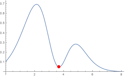

I plotted the function and its derivative, and sure enough, the point I chose is not the true minimum.
The reason for my error was that I wrongly expected that the complex zeros would have the same real part as the real minimum -- which is a rather silly thing to assume, I now realize. So I solved numerically for the complex zero and assumed that the minimum would also lie there.
Thanks.
The function and its derivative:

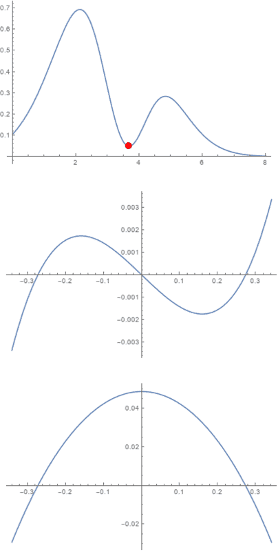

by finding a point where ##\partial u(x_0,0)/\partial x = 0##. You almost did that in your first post, but I believe you didn't use an accurate enough value for ##x_0## for the derivative to be zero. Wolram Alpha says ##x_0## should be near 3.67973. If you plot ##v(3.67973,y)## for ##y## near zero, you should see that the slope is zero.

Yes, it's a bit hard to explain the incorrect thought process that led me to choose the wrong point at which to examine the derivative. I had started out by asking Mathematica to find the complex pair of zeros near the minimum. Then I chose the real part of that pair of zeros as my "red dot" point where I was going to look at the derivatives. This is because I had a sort of subconscious "hidden assumption" in my mind that this pair of complex roots would actually coincide exactly with the minimum point.
I now see that the complex roots should be close to the minimum but not necessarily coincide with it. Perhaps the offset between the true minimum and the complex roots has something to do with the mirror symmetry of the function around the minimum. For example, they should coincide exactly for a parabola that doesn't cross the x-axis.
In any case, your hint helped me to see why my derivative in the complex direction was non-zero around my chosen point, so thanks again!
