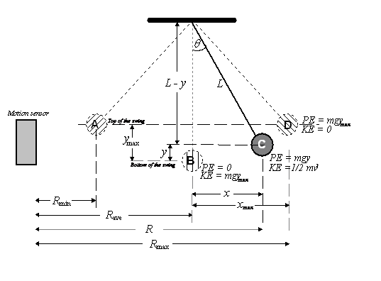

I did an experiment to test the conservation of mechanical energy in an oscillating pendulum. As part of the analysis I had to find the pendulum's vertical position with time using the formula: y = L-sqrt(L^2-x^2) where L was the pendulum's length (L=1 m). Then for the next step I had to find the vertical velocity vs. time. The instructions say that it can be found using derivative(y) so my question is how do I take the derivative of L-sqrt(L^2-x^2)?
When I tried to derive it I got:
f(x) = L - sqrt(L^2 - x^2) = L - (L^2 - x^2)^(1/2)
{d/dx}[f(x)] = f'(x) = - (1/2)[(L^2 - x^2)^(-1/2)][- 2x]
= x(L^2 - x^2)^(-1/2).
I think I did something wrong because when I put in the values of "x" I do not get the same answers as the computer program I am using to generate the graphs did. I have to show a sample calculation of how the data for the graph was calculated so any help would be appreciated, thanks!

We haven't covered torque yet but using a motion sensor I collected data for the horizontal displacement of the ball from the equilibrium position (x vs. time) then to find the vertical position vs. time I used the equation y= L-sqrt(L^2-x^2) where x referred to the values obtained from the x vs. time trials. Now I have to find the vertical velocity found from (dy/dt) the rate of change of the vertical position with time and I'm not sure how to go about doing that.

OH, OK, I think I see . I thought x was = L - y. So x is the horizontal displacement and you have a set of data x(t), right?
Your equation y = L - sqrt(L^2-x^2) is of course right. This is just freshman calculus then: dy/dt = d/dt {L - sqrt(L^2-x^2)} and you have x(t) so you can get x'(t) from adjacent x data points, knowing the time between samples of x.
Forget about theta, it's not relevant to what you're trying to do as I see it.

Could you please explain how I could get x'(t) from the adjacent x data points knowing the time between samples? Sorry, I haven't taken calculus yet so that's why I'm struggling with these basic concepts.

As a hint, an anlogy: suppose you weighed 150 lbs one day and, 24 hrs. later, you weighed 152 lbs. What would be your computed rate of change of weight gain?

EDIT: OK, you don't need calculus. For every x data point there is a corresponding y data point. So to calculate rate of change of y (which is vertical velocity), just do the same with the y set of data points that you did with the x data points to compute horizontal velocity.

I took y2-y1/t2-t1 and I got the right answer, thank you for your help!

OK! To improve accuracy you could compute (y3 - y1)/(t3 - t1) which would average the rate before and after t2.
