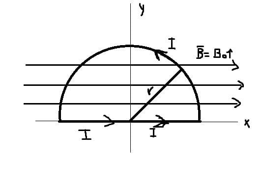

I'm trying to derive a formula for the magnetic torque on a semicircular loop.
what I've done so far is this
The magnetic force on the non-curved loop is
$\vec{F}_{x}=\int Idx\hat{i}\times B_{\circ}\hat{i}=0N$
for the curved loop
$\vec{F}_{c}=\int_{0}^{\pi} Ird\phi\hat{\phi}\times B_{\circ}\hat{r}=-2B_{\circ}Ir\hat{k}$I'm not sure if what I've done is correct. This is all I can do. Can you please help me finish it. Thanks!

Hi Drain Brain! (Smile)
A torque is calculated with respect to an axis.
The general formula is:
$$\boldsymbol\tau = \mathbf r \times \mathbf F$$
where $\mathbf r$ is a vector from the axis to the point where the force is applied.
However, what you have calculated is the total force instead of the torque.
Note that the lorentz force on the right half is into the paper, while the lorentz force on the left half is coming out of the paper.
The logical axis is therefore the y-axis.
(Btw, it also means that the total force on the curve is zero instead of what you have - there's a calculation mistake in there.)
To get the torque with respect to the y-axis, we'd need:
$$\boldsymbol\tau = \int x\boldsymbol{\hat \imath} \times d\mathbf{F}
= \int x\boldsymbol{\hat \imath} \times (I\, d\boldsymbol{\ell} \times \mathbf{B})
= \int r\cos\phi\,\boldsymbol{\hat \imath} \times (I\, rd\phi\, \boldsymbol{\hat\phi} \times B_\circ\boldsymbol{\hat\imath})
$$\boldsymbol\tau = \int r\cos\phi\,\boldsymbol{\hat \imath} \times (B_\circ I r\, d\phi \cdot -\cos\phi\, \mathbf{\hat k})
= B_\circ I r^2\int -\cos^2 \phi\, d\phi \cdot -\boldsymbol{\hat \jmath}
= B_\circ I r^2 \boldsymbol{\hat \jmath}\int \cos^2 \phi\, d\phi

I'm going to present this problem tomorrow. That's why I badly need to understand how to do it
this is the what I did first when I tried to solve it
first I took the lorentz forces on each piece of the loop
for the non-curved part I get $0N$
for the curved part(right) I get $-IB_{\circ}r\boldsymbol{\hat{z}}$
for the curved part(left) I get $IB_{\circ}r\boldsymbol{\hat{z}}$
which when we add will become 0 net force.
now that I determined the lorentz forces
I have to solve for
the torque where I have to plug those in. But now since it's not as simple as I expected it to be, I really want to understand the method that you posted here.
first there are things I want to know about your solution
where did you get $x\boldsymbol{\hat \imath}$? and why did you cross it to $dF$(which I suppose the lorentz force of the first curved(right))
and also how did you arrive from $x\boldsymbol{\hat \imath}$ to $r\cos\phi\,\boldsymbol{\hat \imath}$
and from $(I\, d\boldsymbol{\ell} \times \mathbf{B})$ to $(B_\circ I r\, d\phi \cdot -\cos\phi\, \mathbf{\hat k})$
and lastly what's the limit of integreation?
I know it's a lot of queries. Please bear with me as I want to really understand it fully. Thanks!

Torque is perpendicular displacement times force.
You have found a total lorentz force on the right part of the loop.
But what is its displacement with respect to the axis?
There is no one such displacement - it varies along the loop.
Suppose we pick one small section of the loop.
Say between angles $\phi$ and $\phi + d\phi$, where $d\phi$ is a sufficiently small angle so we can assume that the lorentz force on the section is more or less constant.
Then we can determine the displacement to the axis and we can find the lorentz force on this section.
The perpendicular displacement from the y-axis is the x-coordinate.
In polar coordinates that is $x=r\cos\phi$.
The corresponding vector, that already happens to be perpendicular to the force, is $x\boldsymbol{\hat \imath}$.
The lorentz force is current times length times magnetic field strength, or $\mathbf F_{lorentz} = I(\boldsymbol{\ell} \times \mathbf B)$.
Since we're talking about a small section with length $d\boldsymbol \ell$, we have a corresponding small contribution to the lorentz force $d\mathbf F_{lorentz}$.
$d\boldsymbol{\ell}$ is the vector representing our small section of the loop.
It has length $rd\phi$ and direction $\boldsymbol{\hat\phi}$.
From your drawing, the magnetic field strength is given by $\mathbf{B} = B_\circ \boldsymbol{\hat \imath}$.
Before I write a couple of pages of text that won't help you anyway, can you clarify how much you understand and where you are missing something? (Wondering)
and lastly what's the limit of integration?
I had left out the limits so as not to distract from what is really going on.
On the straight section, the lorentz force is zero everywhere, so this does not contribute to the torque.
That leaves the circular section running from $\phi=0$ to $\pi$.

finishing up with the problem,$\boldsymbol\tau=B_\circ I r^2 \boldsymbol{\hat \jmath}\int \cos^2 \phi\, d\phi$
$\boldsymbol\tau=B_\circ I r^2 \boldsymbol{\hat \jmath}\int_{0}^{\pi} \frac{1+\cos(2\phi)}{2}d\phi$
$\boldsymbol\tau=B_\circ I r^2 \boldsymbol{\hat \jmath}\int_{0}^{\pi} \frac{1+\cos(2\phi)}{2}d\phi = B_\circ I r^2 \boldsymbol{\hat \jmath}[\frac{1}{2}+\frac{\sin(2\phi)}{4}]_{0}^{\pi}$
$\boldsymbol\tau=\frac{B_\circ I r^2 \boldsymbol{\hat \jmath}\pi }{2}$ --->>>> My final answer is this correct?

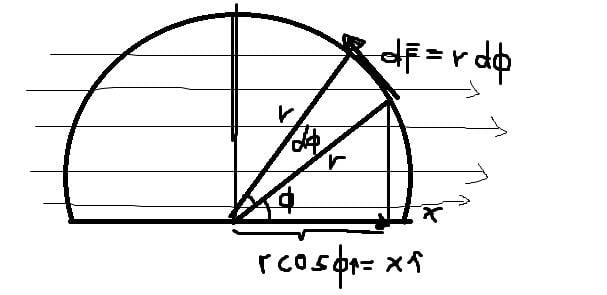

I redraw the image that I posted above can you check if they are correct.
Well...
  • It's not running from 0 to $\pi$ anymore - it's doing a bit more now.
  • What you have drawn as $d\mathbf F$ should instead be $d\boldsymbol \ell = r d\phi\, \boldsymbol{\hat\phi}$ and it should be slightly shorter, connecting the 2 radial line segments.
  • There should be an additional vector $d\mathbf F$ going into the paper.
(Wasntme)
