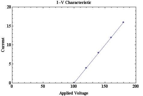

You are working with a device in a black box which has two terminals, which are in turn, part of a larger circuit. You measure the voltage and the current at the terminals and record the following:
vi (V) | i1 (A)
100 | 0
120 | 4
140 | 8
160 | 12
180 | 16
a: construct a circuit model for this device using a current source and a resistor
b: How much power will the device deliver to a 20 ohm resistor?

Have you studied Thevenin and Norton's theorems? You may have to do some more research on your own; it's a good way to reinforce the learning experience.
When you have a two terminal device (your black box), you can learn something about it by determining the I-V characteristic. You do this by applying a voltage to the terminals, measuring the current into the terminals and plotting the measured data.
Imagine that your black box contained a 5 ohm resistor and you applied some voltages, measured the currents and plotted the results. You might get something like this:
Now, make a similar plot of your problem data:
Since by now, you've looked up Norton equivalents, what does the fact that your problem data doesn't go through the origin tell you?

Ok, so what happens is you have a voltage source ( I'm kind of thinking of it as someone stuck a battery in the wrong way lol).
So basically, you get your two voltage sources equalling positive 100v and negative 100v, and the equal opposites cancel each other out. So the current would be 0.
I think I see where you're going at with this! My initial values state:
V: 100, A: 0
V: 120, A: 4
V: 140, A: 8
V: 160, A: 12
V: 180, A: 16
Well, these numbers if you subtract one hundred from them all, and divide them by 5, give you those numbers.
I'm still a little confused to as what exactly I'm supposed to do with a current source however. The problem specifically says model it with a current source, but first of all, I have no idea what a current source is in a real life application (that's usually what helps me visualize this stuff in all reality), and second, my attempts here at building a circuit that functions off of this "current source" aren't yielding any numbers that are correct.

You've got it! Pretty cool, huh?
Thevenin's and Norton's theorems provide two different ways to model the behavior at the terminals of a black box.
Basically what Thevenin says is that if you have a black box with two terminals, and in that black box are a bunch (network) of resistors and voltage and/or current sources, all hooked up in any way whatsoever, with the black box terminals connecting to two points within that complicated network, you can represent the behavior at the two terminals with a single voltage source and a single resistor in series with that voltage source.
Norton says that with the same network in the black box, you can equally well represent the behavior at the terminals with a current source in parallel with a single resistor.
This means that you can always convert a Thevenin equivalent to a Norton equivalent. The Norton equivalent is what your problem is asking for.
You figured out how to answer the question with a Thevenin equivalent. Now go do some independent research and learn how to convert a Thevenin equivalent to a Norton equivalent.
