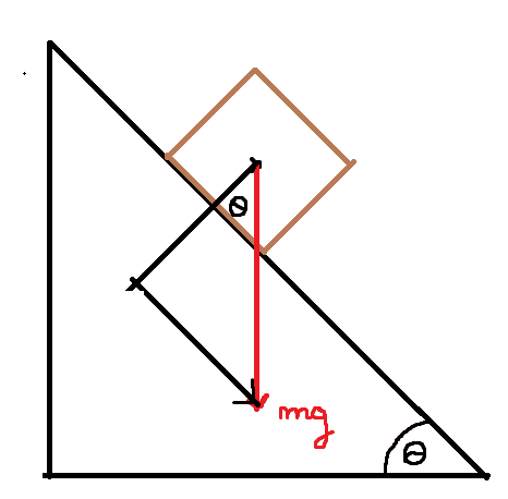

What's the minimal angle of a ramp such that a cube with side 10 cm placed on it will tip over? The coefficient of friction between the cube and the ramp is 0.6.
I have given it some thought and I have come to certain conclusions:
I think that the cube will tip over once the force of gravity has gone outside its base - the critical angle is plotted on my diagram.
The angle between the vertical component of the force of gravity and the force itself is 45 degrees, because the line containing the force vector also contains the diagonal of the square. The vertical component is parallel to the side of the cube, therefore, the angle must be 45 degrees.
This implies that the angle of inclination is also 45 degrees (triangle similiarity)
Does it mean that the minimal angle for a cube to collapse is always 45 degrees, regardless of the size of the cube and the coefficient of friction?
This is not correct. Consider a frictionless ramp. It will slide rather than tip at any angle. And a high friction ramp will tip earlier. So the coefficient of friction must be a factor.
That means that your tipping condition is incorrect
At what angle will it slide?
@CWatters
When $\mu = \tan(\theta)$ so that's around 26 degrees.

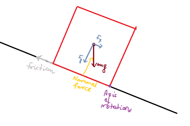

I have thought about this problem a little bit more and I've come up with another approach.
The cube will tip once it gets a non-zero torque in the clockwise direction with respect to the axis I marked.
There are several forces that contribute to the torque:
1. Normal force and the vertical component of the force of gravity - they act at the same perpendicular distance, have the same magnitude and act in opposite directions - their torque cancels out.
2. The horizontal component of the force of gravity - its torque is
$$\tau = mg \sin(\theta) \cdot \frac{a}{2} $$
3. The force of friction, but its torque appears to be zero.
Thus, I must have confused something, because my reasoning implies that this object will always tip.
Could somebody give me a hand?
Use the center of mass instead.
Check your assumption about where the normal force acts. Is it a reasonable assumption for this scenario?
@Dale
Intuition tells me that the normal force should be "shifted" to the right, but I am unable to determine the exact distance.
Will the normal force, right before tipping, act directly on the point I chose as the axis?
@Dale
Yes, that is correct. The distance changes depending on the slope, and it is the distance required to have 0 torque.
Why doesn't the one I chose work?
If you use a reference point other than the center of mass, then a torque imbalance around that point doesn't necessarily imply that the the block starts rotating. A purely linear acceleration can also represent a change in angular momentum around some reference point.
