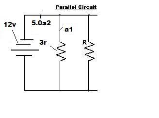

a 3.0 ohm resistor an unkown resistor r and two ammeters a1 and a2 are connected with a 12 volt source ammeter a2 reads a current of 5.0 amperes
1) detemine the equivalent resistance of the circuit
2) caculate the current measure of ammeter a 1
3) caculate the resistance of the unknown resistor r
v= 12 v
a2 = 5.0 a
a1 = ?
r1 = 3.0 ohm
r2 =?
this is a parallel circuit so
do i use v/a to find equivalent resistance?
for current do i use v/r to find a?
and for the resistor is this equation right 1/req = 1/r1 + 1/r2
i got 2.4 ohm for the equivalent resistance and 4 a for the current don't know if it right
There's no way to answer this without seeing the circuit.
oh here a picture of the diagram for the problem
The answers you have so far are correct. What exactly makes you doubt your solution?
You are correct so far, so why not go on to find the resistance of the unknown resistor using the formula you have: \frac {1}{R_{eq}} = \frac{1}{R_{1}} + \frac{1}{R_{2}}
ok i got 12 r for the resistor using that equation
Which is correct, apart from the units; the units of resistance are Ohms, \Omega.
