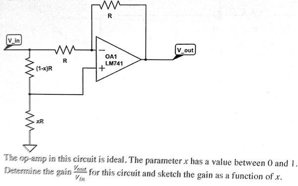

I have two "golden rules" I was given which are "no current into the op-amp" and [itex]V_{-} = V_{+}[/itex]
and the open loop gain is infinite
Basically my notes and textbooks are leaving me with pretty much nothing though
tried determining the currents like we did in other methods. tried figuring out the case when x=1 and x=0. I don't get how current can flow across the resistor if V_=V+. I'm basically completely lost. No Idea where to start.
Using your "golden rules", given a voltage V_in at the input, what will be the voltage at the + terminal of the op-amp? (Hint: you're looking at a simple voltage divider).
So, what then is the voltage at the "-" terminal?
well I would say [tex]V_{+}=\frac{xR}{(1-x)R+xR}V_{in}[/tex][tex]V_{+}=x[/tex]
and my golden rule says that V_=V+

Well, ##x\,V_{in}##, right?

Good. So what's the current through the input resistor, R?
oops I meant V-=xV_in
the current through the input resistor would be [tex]\frac{V_{in}-xV_{in}}{R}=\frac{(1-x)V_{in}}{R}[/tex]so[tex](1-x)V_{in}=xV_{in}-V_{out}[/tex][tex]1-x=x-\frac{V_{out}}{V_{in}}[/tex][tex]\frac{V_{out}}{V_{in}}=2x-1[/tex]?
if my work is hard to follow I just said that the current through the input resistor must equal the current through the feedback resistor after the "so".
this makes sense to me now so I hope it's correct haha.
Looks good. For someone who started out with "no idea", you've carried it off nicely :smile:
