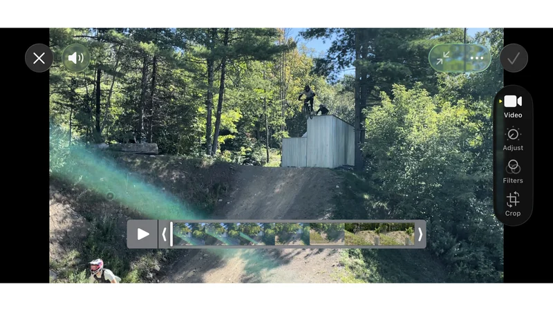

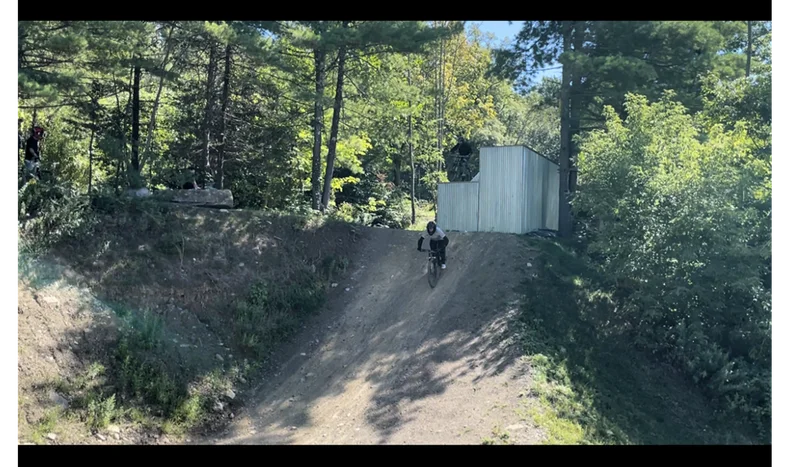

@berkeman I'm in the grey shirt. This is Mt. Creek Bike Park in New Jersey.
This is me coming off of a pretty nice sized drop.
And landing!
We are all in our 40's and 50's. I only get out to do this 1 to 2 times annually. Otherwise we prefer to ride technical XC (Enduro).

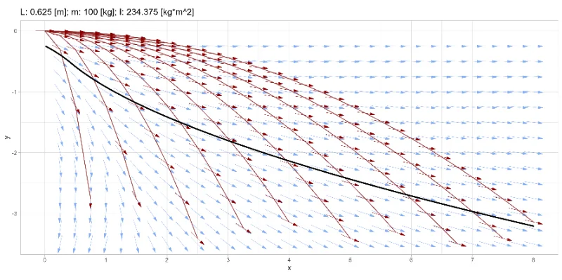

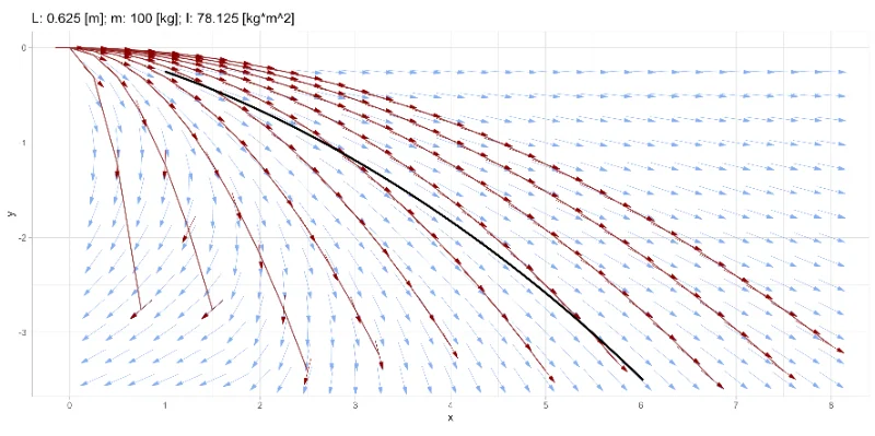

@erobz Another numerical solution approach:
- Define a vector field, by assigning each point in space the orientation of the bike during a jump from a given launch point.
- Use a streamline algorithm on that vector field, to compute the landing ramp profile that is always parallel to the local bike orientation vector.
@erobz I have experimented with the approach above a bit. I'm getting the impression that the inverse relationship of ##\omega## and ##v## can make it difficult to find a landing zone profile that results in a two wheel landing for a wide range of ##v##.
What range of ##v## can be covered, is highly sensitive to the relationship ##\omega(v)##, which is affected by the active measures the rider takes to avoid front wheel drop. In the two examples below I changed ##I## to demonstrate this. The values of ##I## are unrealistic, I just use them to reduce ##\omega## which could also be achieved by rider actions.
arrows: bike orientations
red lines: example trajectories for ##v=1 \dots 10 m/s##
black line: example landing zone profile with 2 wheel landing for the trajectories which intersect it.
Reply
A.T. said:
So the drop height (minimum the rider drops) here is like a third of a meter here in these graphs? If the moment of inertia is low the profile is convex, and if high it becomes "mostly" concave. All interesting things.
Given that most bikes and riders are similarly sized; in a passive drop (one that lets physics control the rotational dynamics as opposed to the rider input) there could be a "most" reasonable profile for the most averagely sized rider on a given drop it seems.
Yeah, but the ##I## required for the concave profile (2nd plot) assuming passive rider is unrealistically high. In real life, making ##\omega## that low, would require an active rider.
Passive drop with somewhat realistic ##I## results in those convex profiles (1st plot), which cover only a small range of ##v##, and even in the valid range of ##v## you never fly very high above the ground. That's because the orientation of the bike is very close to its motion direction (see red arrows along the trajectories).
But to be honest, I don't really know the actual ##I## of a passive rider. Just that the optimal profile is highly sensitive to ##\omega##, which makes it rather difficult to find one that works for all riders. I think that at very low speeds, even novice riders will intuitively try to counter the front wheel drop.
