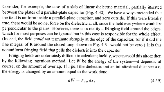

Hey SIr , (Addressed to Sir J D Grififfiths)
Last year when I took basic electricity and magnetism course , my instructor discussed some interesting ideas which you discussed in your book ''Introduction to Electrodynamics'' ,one of that was calculating force exerted on a dielectric while it's to be inserted in a parallel capacitor(Chapter 4 Electric Fields in matter;page 196-7)
Therein you have made one mistake ! -So said my instructor !
You said -
Reference-
Clarification-
When the capacitor isn't connected to a battery V will change , so the force on dielectric (exerted by capacitor pates) in case when the capacitor plates are maintained at constant potential difference, will differ from the force exerted when the capacitor plates aren't maintained at constant potential difference.

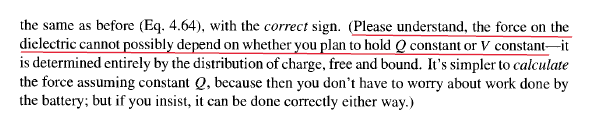

I don't see any mistake in the cited derivations in the textbook. It's of coarse the quasistatic approximation, i.e., any radiative effects are neglected.

Of course for ##Q=\text{const}## the voltage changes, but that's why Griffiths correctly expresses ##W## in terms of ##Q=\text{const}## rather than ##V## when taking the derivative wrt. ##r##.
He also correctly demonstrates what happens when ##V=\text{const}## (e.g., by connected the capacitor to a battery): Then ##Q## changes and one has to take into account both the change of energy due to moving the dielectric against the forces (of the here cleverly neglected fringe fields!) as well as due to the transport of charges through the battery. As I said, I don't see anything wrong in his derivation in both cases.

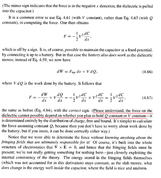

But Griffiths gives a very clear proof in his book. It's as follows
(a) Keep the capacitor charged with total charge ##Q## (disconnected from the battery). The electric energy stored in it is
$$W=\frac{Q^2}{2C},$$
and thus
$$\vec{F}=-\nabla W=\frac{Q^2}{2C^2} \vec{\nabla} C.$$
Now you can get the capacitance with the dielectric moved in by ##x## (as in Griffiths's Fig. 4.30) as a parallel circuit of two parallel capacitances: One capacitor is of length ##x## and width ##w## filled with vacuum (or air) where ##\epsilon=1## and the other part is filled with the dielectric with ##\epsilon## as the dielectric constant. Thus you have (in Heaviside-Lorentz units)
$$C=C_1+C_2=\frac{w}{d}[x+\epsilon_r(l-x)]=\frac{w}{d}(\epsilon_r l-\chi_e x),$$
where ##\chi_e=\epsilon_r-1## is the electric susceptibility of the dielectric. Thus you get
$$\vec{F}=\frac{Q^2}{2C^2} \frac{-\chi_e w}{d} \vec{e}_x=-\frac{V^2 \chi_e w}{2d} \vec{e}_x,$$
which is exactly what Griffth's gets out too.
(b) Capacitor plugged to the battery
Then when moving the dielectric by some infinitesimal ##\mathrm{d} x## the capacitance changes a bit and thus to keep the voltage constant you have to move some charge
$$\mathrm{d} Q=\mathrm{d} x \frac{\mathrm{d}}{\mathrm{d} x}(C V)=\mathrm{d} x V \frac{\mathrm{d} C}{\mathrm{d} x}=-\mathrm{d} x \frac{\chi_e w}{d}.$$
Thus we find
$$F_x=\frac{\mathrm{d}}{\mathrm{d} x} \left (-\frac{C V^2}{2}+V Q \right) = \frac{V^2}{2} \frac{\mathrm{d} C}{\mathrm{d} x} = -\frac{V^2}{2} \frac{\chi_e w}{d},$$
i.e., the same as in case (a). As I said, that's a very clear derivation, and I don't see where there should be a mistake.

In case (a) we calculated the change of ##V##, which is due to the change in ##C## when expressed in terms of ##Q=\text{const}## and ##C##. In case II we have exactly considered the case of constant ##V## which implies that also the charge changes and that you have to take into account the corresponding work done by the battery to provide the change of charge. So we exactly did what you claim we didn't!

Well, in Griffiths's and my derivation (which are identical) they are the same, and they should obviously be.

They are not as demonstrated by Griffiths. If you don't want to believe a clear mathematical derivation, I cannot help you.
