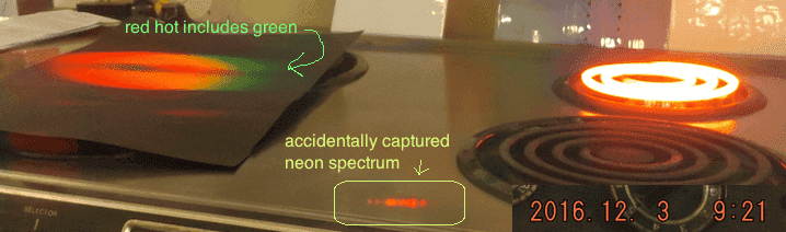

sophiecentaur said:
For a hot 'black body' the spectrum covers the whole of the EM spectrum with a peak around the 'red' wavelengths
I proved to myself a couple of years ago that there is green light present in a red/orange hot electric stove burner. (≈1500°F / 800°C)
Photo through a diffraction grating of a red-hot electric stove burner, showing a smeared spectrum from red through orange to green, with an annotation reading red hot includes green; also a faint spectrum of a neon lamp, labelled accidentally captured neon spectrum.
This image was taken through diffraction grating.
I also captured the fuzzy spectrum of the neon "On" lamp on the front of my stove, which is a different kind of "color" altogether. (I think. :biggrin:)

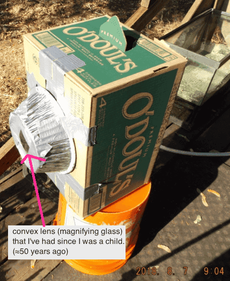

Oh my.
For several years I've been wanting to do a "spectral analysis" of a banana, to figure out if it's true that they aren't really yellow.
Your question finally prompted me to do the experiment.
Albeit, I used a lemon this morning, as, I kept eating my previous experimental subjects...
Anyways, here are the results of this morning's experiment:
Experimental apparatus:
Photo of a homemade apparatus: a cardboard O'Douls box with a convex lens taped to its front, sitting on an orange bucket outdoors, with a pink arrow labelled convex lens (magnifying glass) and a timestamp of 2018 8 7 9:04.

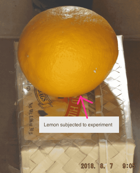

Subject of experiment:
Photo of a whole lemon resting on a woven basket-style box with a partly visible printed label, with a pink arrow and caption reading "Lemon subjected to experiment"; timestamp 2018. 8. 7 9:05.

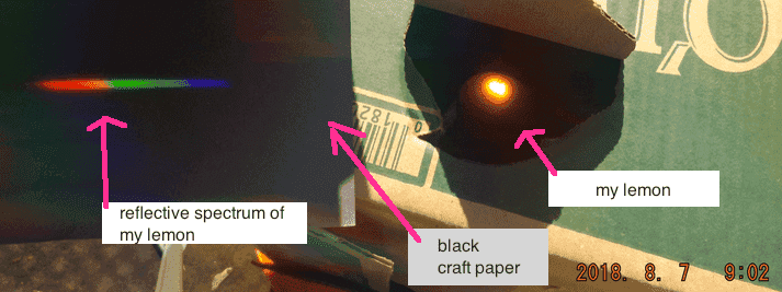

Results of experiment:
Photo of a lit lemon inside a black craft paper box, with a faint horizontal rainbow spectrum on the left labelled reflective spectrum of my lemon, a 2018 date stamp in the corner.
Conclusion: Lemons are white? :oldconfused:
hmmmm...
Conclusion: Eyeballing intensity levels at different frequencies and is not a good way to quantitatively measure a spectrum. The logarithmic response of the eyes will tend to make every frequency appear to be illuminated with rough uniformity.
Conclusion: Every experiment needs a control. If you look at the spectrum for an apple, or a piece of white paper compare it to one for a lemon and fail to find a difference then you have a real problem with your methodology. If you do find a difference, now you're getting a meaningful result. Side by side recommended -- eyes are designed to detect differences in illumination, edges.
Run the eye dropper sample tool on your Photo processing program and notice the RGB values on the image. There may be a Luminance option button - or convert to monochrome. That will show you a difference when compared to a white card (in shadow to avoid 255 255 255 saturation)
