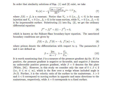

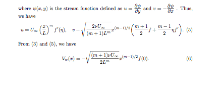

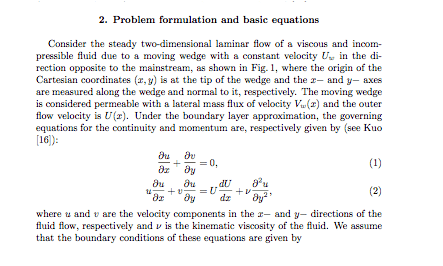

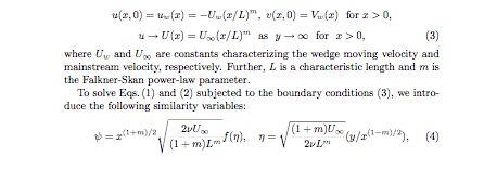

But also I found it in the pages I posted below. (here there is a moving ramp in opposite direction of freestream and also suction at wall)

The difference is the choice of similarity variable. The behavior of all of the equations is effectively the same but the variables have been normalized slightly differently. It's similar to how you can find two versions of the Blasius equation.
