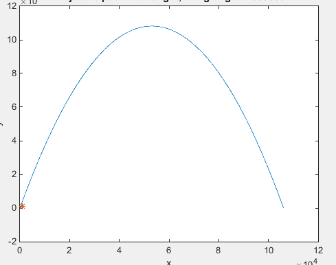

The following series of differential equations represents a projectile's path when solved (g=9.81):
Modify this series of differential equations to account for an additional force F with vector components a and b acting on the projectile.
Here is a sample plot of this system:
See above.

Knowing that gravity is a force with a positive i-component and negative j-component, I attempted to apply the same logic to F. This resulted in:
vdot = -g*sin(theta) + a*cos(theta) + b*sin(theta)
and
thetadot = -g/v*cos(theta) + a/v*sin(theta) + b/v*cos(theta)
However, that solution didn't appear to be correct, as when I plotted this out with F with a positive i-component and a negative j-component, I got this plot:
From intuition, the positive i-component should have caused the projectile path to move to the right more (hard to describe in words, but I hope you get what I mean), but instead, with my system (somehow), the projectile somehow happens to move to the left and go to the negative x-axis. Because my attempt to apply how gravity was represented in this system to how an arbitrary force would be represented, well, failed, I am currently stuck.

Check the signs in your thetadot equation.
Flipping the sign of the second term appears to make it be more reasonable, and I understand why that makes sense from a directional perspective. However, I'm unsure if the actual magnitude is correct, if you get what I'm saying...
Here's what it looks like with a flipped second term:
It's more reasonable, but I don't understand it from a trigonometry perspective. In addition, if that's the case, shouldn't I also flip the sign in the vdot equation? If not, why?
Patterns like
+sin +cos
-cos +sin
arise frequently, since as a matrix it represents a rotation.
While moving up and to the right, v is in the first quadrant but ##\dot \theta## is in the second quadrant, so a force horizontally to the right is positive for ##\dot v## but negative for ##\ddot \theta##.
