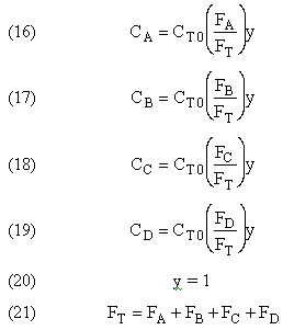

While I was researching for more possible clues, I found this thing:
http://www.umich.edu/~elements/course/lectures/six/
And at the example C, it's approximately close to what I need (except it's a parallel reaction in a PFR, what I need is a batch reactor - but hey I can manage to make series rate equations, at least for constant volume ones). I just have particular trouble in trying to understand the stoichiometry part and with that, I have some important questions to ask:
1) I don't understand why did these terms exist:
Is it somehow similar to what Fogler's ECRE which is δ=d/a+c/a-b/a-1? I could not comprehend what made it this way. Further isn't F for molar flowrates? If I use this for batch reactors instead, should I use N? Lastly, what is y there?
