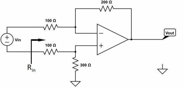

Find Vin/Vout
Vout = Rf/R1(Vb-Va) ?
I think the answer is the first one.

  • Circuit schematic of a differential op amp: Vin feeds the inverting input through a 100 Ω resistor, and the non-inverting input through a 100 Ω series resistor and a 300 Ω resistor to ground; a 200 Ω feedback resistor connects output Vout to the inverting input.

Can you show us how you arrived at your conclusion? We won't confirm a guess...
Hi joey5981. http://img96.imageshack.us/img96/5725/red5e5etimes5e5e45e5e25.gif
So you believe the 300 ohms resistor (and its 100 ohm companion) do nothing here? How can you prove this?
Vin/Vout = -2, ...
The gain was given as this? Or did you mis-type what the book showed as Vout/Vin?
Due to the unequal 200 and 300 ohm resistors this is not a differential amplifier in the accepted sense. In other words, it has a huge common-mode gain.
If you accidentally labeled the 300 ohm resistors so it should have been 200 ohms, then you should come up with a computation as gneill asks for.
