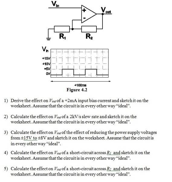

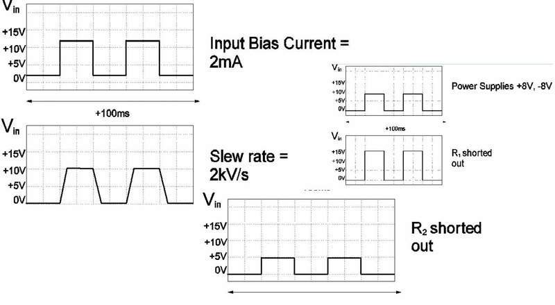

gl0ck
85
I think I figured out the 1st question. The result I got is Vout=2*Vin+2V.
Which means twice as big wave as the Vin and shifted with 2V.
Is this enough or I have to write equations like 2nd -> Vout = 2*Vin+2V?
or
2) 2kV/s is the same as 2V/ms, or 20V in 10ms
3) Vout “clips” at ±8VIn fact it would be rather worse than this, as the output would not quite make it to the ±8V supplies.4) Short-circuit across R1 means that negative feedback has gone and the Op-Amp is simply comparing its input to 0V, multiplying the difference by the raw Op-Amp gain (very large) and thus saturating Vout at the (positive) power supply of +15V
5) Short-circuit across R2 makes the circuit into a unity-gain buffer with R1 as its load resistor, so Vout = Vin
or
That depends on whether the bias current flows into the + or - input. If into the + there is no effect. If into the - there will be an output offset. Can't verify your answer since you didn't give us the values of R1 and R2.
Impossible to answer (2) and (3) unless R1 and R2 are given values.
If the input is
and what about negative outputs? Actually, with an ideal op amp and the input going from exactly 0 to +5V, that question cannot be answered! The output is equally likely to stay at +15V or switch between + and - 15V. (Why?). But you have the right idea here.
That is correct.

rude man said:
see above in red
shows a non-inverting Op-Amp circuit. *Its input waveform, Vin is a square wave with minimum and maximum values of 0V and +5V respectively. *R1 and R2 are both 1kΩ resistors. *For all of this assignment, apart from (3) below, assume that the Op-Amp’s power supplies are ± 15V.
The resistors values are 1kOhm
and the power supply is +-15V
or
That depends on whether the bias current flows into the + or - input. If into the + there is no effect. If into the - input your output expression is correct.
So draw the input and output waveforms.
Correct.
With an ideal op amp and the input going from exactly 0 to +5V, the output will obviously be hard-over +15V when the input is at +5V. But what about when the input is at 0V?
That is correct.
