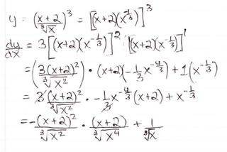

I did what Mark44 said, then I used the chain rule and the product rule. This is how I did it:
But what do I do next? Do I have to do all the multiplication to bring everything under a single denominator? Because I don't seem to be getting the right answer that way... did I do everything right?

The 3rd line is the derivative you want, and you can stop there. Anything else you do after that is algebraic manipulation. I should point out in this line that you need a pair of parentheses surrounding everything after the dot, and the same is true for the two lines after that.
You have a mistake in the 4th line where you cancel 3s, and this is related in a way to the lack of parentheses around the terms following the dot.
