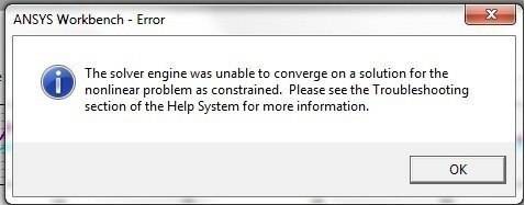

Hi,
I am trying to analyze the effects of pressure on the automotive t=ire by modeling and simulating the same in ANSYS workbench. However, I am having trouble applying material conditions to the model.
I wish to use mooney rivlin material but when I apply that based on the guidance given by the following link, my solution does not converge.
video link:
My boundary conditions are fine because if I use a material such as steel, I get a solution.
Kindly help me and let me know where I could go wrong.

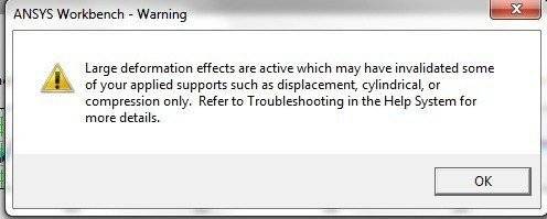

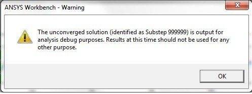

Following are the error messages that I obtained:
substeps:
initial: 20
minimum: 10
maximum: 100
two more errors continued.
  • What does the force convergence chart look like, was it slowly converging or bouncing all over the place?
  • Are you sure that your model is fully constrained? Does the deflection look something like you're expecting or is it mainly solid body movement?
  • Are you applying a contact condition on the bottom of the tire? What properties are you applying to that boundary?
Mech_Engineer,
The convergence curve begins from below, oscillates about the main line. I do get points in the run where there is convergence but the last two or three points don't converge leading to no solution.
The boundary conditions are alright because if I apply steel as the material to the same model, I get results without any problems.

It sounds to me like the model isn't converging because you don't have enough substeps. You should consider increasing the number of substeps, and applying your pressure gradually through load steps.
Ideally, the force convergence graph should start above the line and converge to below the goal line. If it oscillates about the goal line a lot I'm thinking it means the perturbed system is oscillating; a gradually applied and solved-for load may help with this.

I think you're going to have to try some simplification and see what it takes to get it to converge, either through a simpler geometry and/or simpler material model. Once you're able to get a solution, you can slowly add complexity and see at what point the model is no longer converging. My guess is the pressure load needs to be applied slowly with load steps; how much pressure are you applying? Have you tried a lower pressure to see at what point you can get a solution?
I am applying a pressure of 0.7 Mpa.
No, I have not tried to apply a lower value of pressure on the tire yet to see if that works ok.
I will be doing that now to see if I get some convergence.
Thanks
Try applying something much lower for a start and see how it goes. A pressure of 0.07 MPa might be a good starting point, and could provide you with the structure of load-stepping up from there.
It seems possible your tire is not able to hold 0.7 MPa and is failing to converge because it is structurally failing. A lower starting point might help you visualize this.

The "recmmmended maximum pressure" will be for the real tire including the steel reinforcements, not for a rubber ring with no reinforcement.
Exactly what I was getting at. The model isn't converging because just rubber can't hold that much pressure. I'm guessing your modeling efforts will start to converge when you apply less pressure, but the deformations won't really match those of a "real" reinforced tire.
AlephZero & Mech_Engineer,
I didn't think of it.
I found my mistake. When I reduced the pressure significantly to 0.06 psi, The solver was able to converge.
