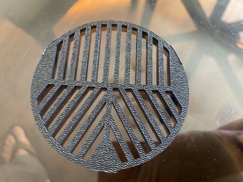

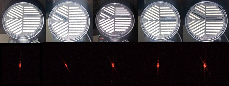

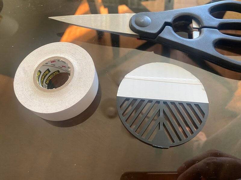

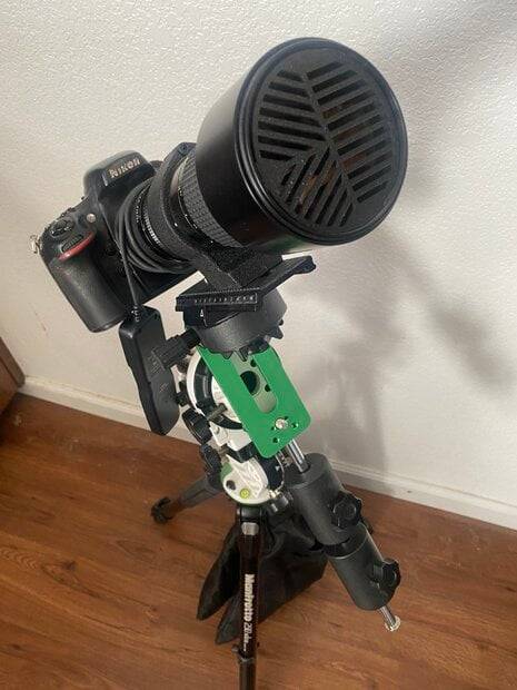

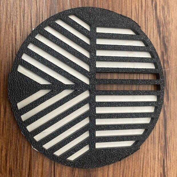

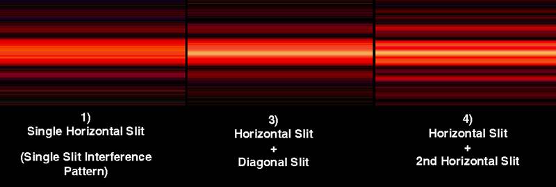

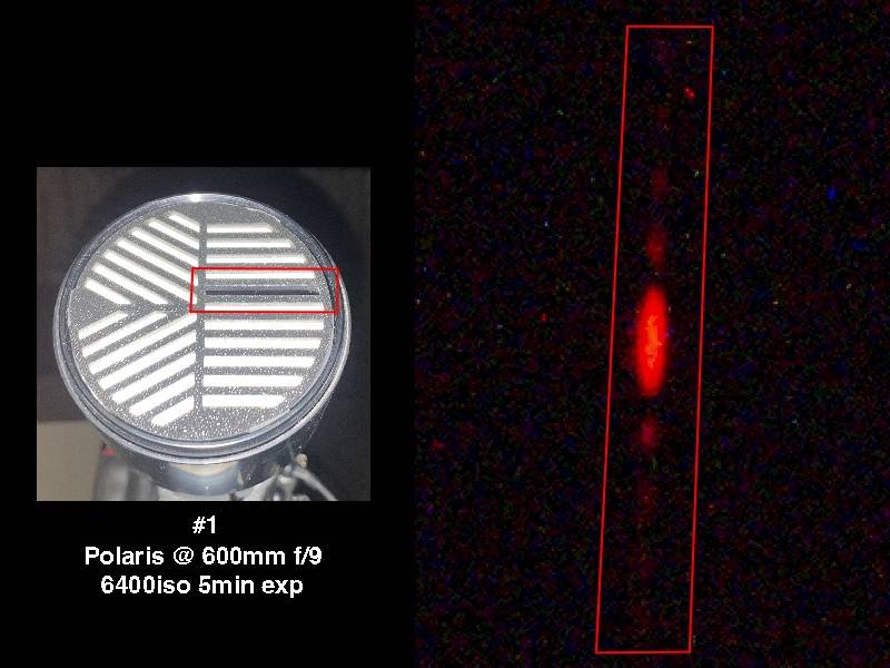

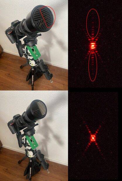

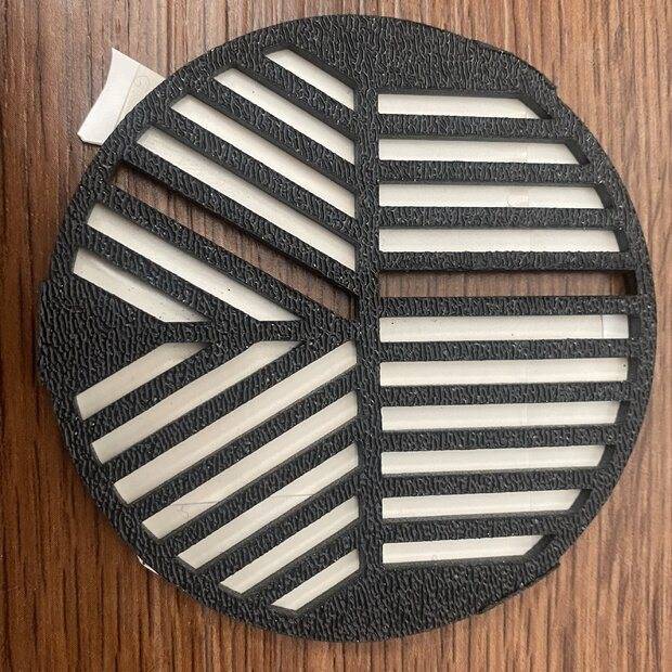

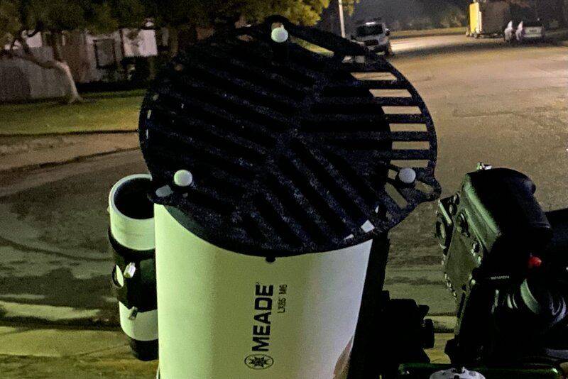

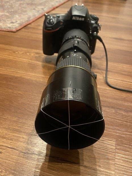

I tried another diffraction test with 6 spikes, but only so-so results. My exposure times were limited by thin clouds and Bortle 6 light pollution. This is a composite of around 120 exposures of Polaris, about 15 seconds per exposure at 6400iso with wire over the lens to create a 6 spike diffraction pattern.

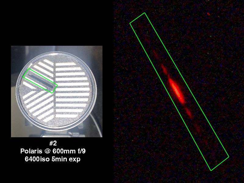

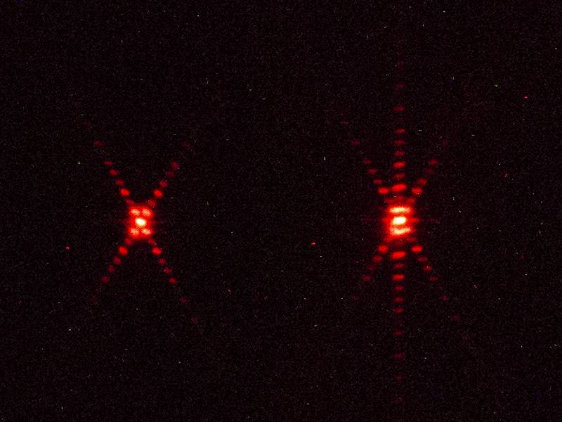

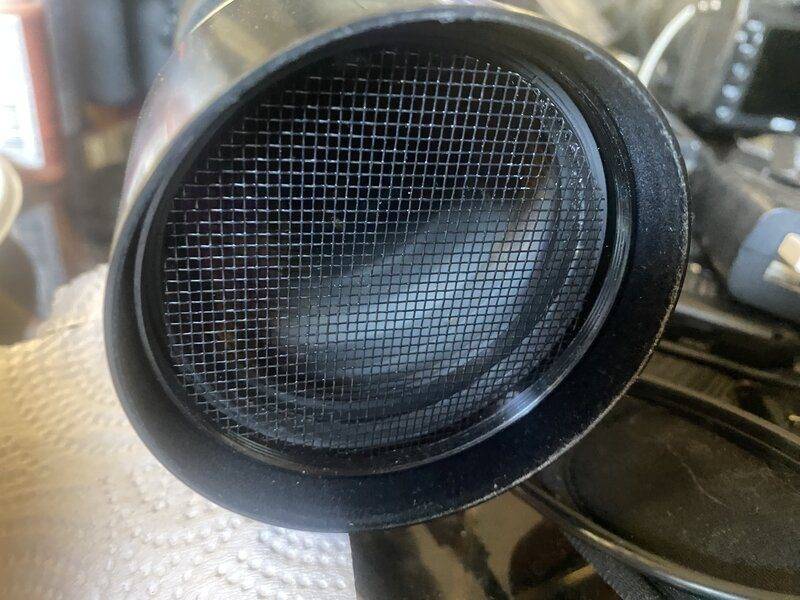

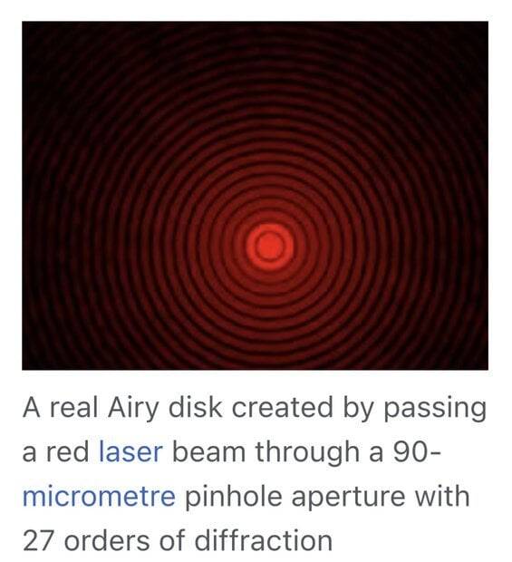

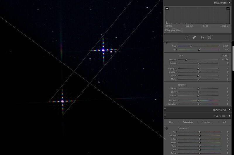

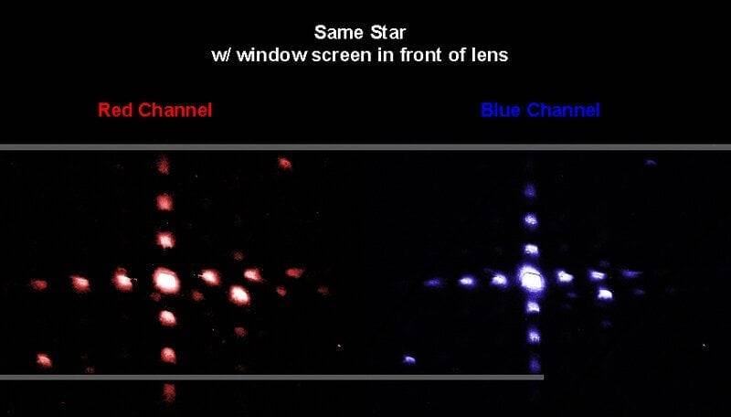

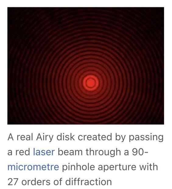

Well since the 1st maxima of an airy disc of red light is larger radius than the 1st maxima for blue light of equal intensities, if we’re imaging laser point sources I wonder if the spikes would be longer for a red laser compared to an equal intensity blue laser. With the question posed this way we don’t have to worry about sky background or sensor sensitivity.
When I look at this test photo I did last night, to my eye the tips of the spikes are red, then a bit inward we have green, and further inward still we have blue.
  • #66

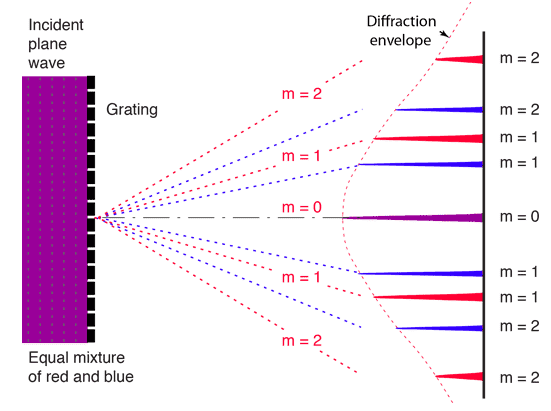

They will have a 'length' roughly proportional to the wavelength (also the spacing of any 'dots'. That is if everything else is controlled.
But images of sharp objects in space are mostly not monochromatic so we're really looking at the colour fringing at either end of the spikes and differences hard to discern.

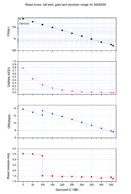

That claim is false. The 16 bit depth of the sensor is not the limiting factor. In later posts I explained why, complete with examples and some practical mathematics to achieve increased effective bit depth. But this 16 bit sensor seems to repeatedly brought up as an insurmountable limitation, even though in and of itself, it is not. Of course there are real-world, practical limitations regarding the dimmest things are possible for JWST to resolve. But this least significant step of the 16 bit ADC, by itself isn't one of them.

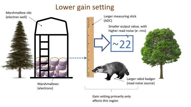

Gah! The stacking process is not nonlinear. With the exception of cosmic ray/hot pixel rejection and removal, (which might be considered part of the stacking process), it's linear in the
  • astrophotography sense: being performed well before the "stretch" or "curves" are applied (stacking is done in the process flow immediately after calibration frames are applied to the raw data from the sensor)
  • the mathematical sense: \mathcal{O}(x + y) = \mathcal{O}(x) + \mathcal{O}(y),
  • and any other sense that I can think of.
Cosmic ray/hot pixel identification, rejection and removal fit in nicely as part of the stacking processes. But this isn't a necessary part of stacking. You could still do stacking without it.
Doing just the stacking alone, the mathematical operation is linear. As a matter of fact, it's mathematically equivalent (statistically speaking) to taking a longer exposure with unlimited bit depth (zero risk of causing saturation beyond that of the subframes), at the expense of additional read noise.
And this addition of read noise does not make the process nonlinear. (Any more than the addition operator is nonlinear, which it isn't.) Nor does this read noise present an insurmountable limitation if the read noise is uncorrelated/(statistically) stationary. The overall effect of the read noise can be reduced via the Central Limit Theorem, just like any other source of uncorrelated, (statistically) stationary noise source.
You're right to be concerned about saturation during a single exposure. Saturation is a primary consideration for determining the exposure length of subframes. After that, enough frames are stacked to bring about the necessary detail and signal to noise ratio (SNR) determined by the scientific needs of the object being imaged. If the science requires more effective bit depth or better SNR, more frames are stacked.
The read noise penalty for stacking is small, although it's not negligible, so it's something that is considered and dealt with. But it's in no way an insurmountable obstacle. And to the point of the last claim, there's nothing inherently nonlinear about it.

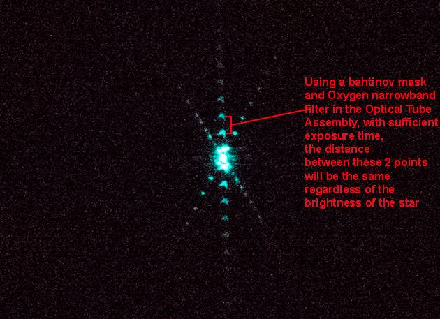

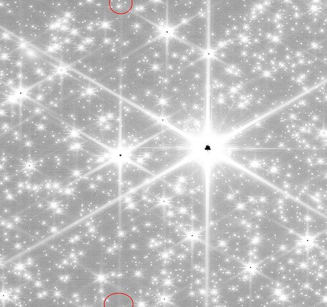

Sure. Right here. @Devin-M was kind enough to generate one with direct experiment. Those two stars are of different brightness (as acquired directly from the camera). But when adjusting for the intensity, it's quite clear that the diffraction patterns are of the same size.
Edit:
sophiecentaur said:
Perhaps the actual wording of the statement implied something to you that was not intended. No one has suggested that diffraction theory is wrong; diffraction assumes linearity.
My objection was your statement where you said the spikes were not "detectable" (italics mine). I don't have an objection to saying that they were not detected in a particular image. But they are in fact detectable.

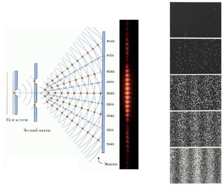

No it doesn't. It essentially says, among other things, that the standard deviation of a set of averaged trials decreases by a factor approaching \frac{1}{\sqrt{N}} compared to the standard deviation of the original set of trials. It says absolutely nothing about saturating sensors.
sophiecentaur said:
You hop from 16 to 32 bit quantisation and you ignore any effect of nearby stars. 16bits (any sampling and quantising aamof) introduces non-linearity.
The input is already quantized. From the very beginning. It starts with individual, quantized photons. From there all merely count them. We sum them. Sometimes we divide the results by a number. Nothing about any of that is nonlinear.
We can put those numbers in a 16 bit register or a 32 bit register. We can store those numbers in a file using 16 bit format or 32 bit floating point format. It doesn't matter.

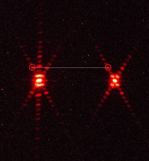

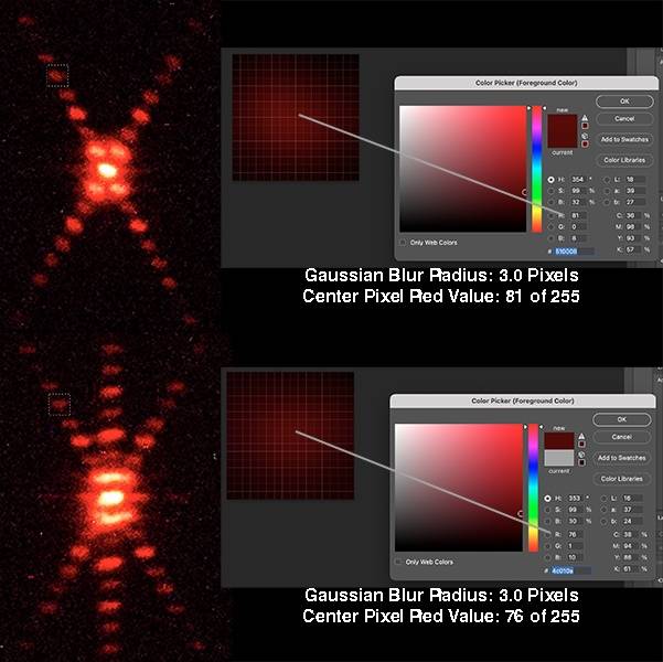

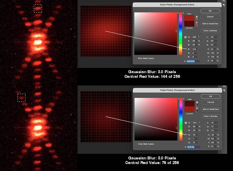

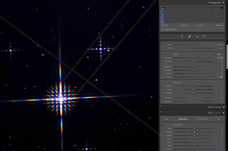

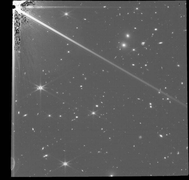

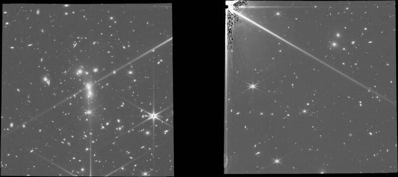

Two stars in the image have been manipulated to have equal lengths but other stars in the field show none at all! Regards Andrew
  • #72
The image was manipulated so they have roughly equal brightness (even though they originally were not). The adjustment was done to make it an apples to apples comparison. The equal sizes naturally fell out of that.
Here is the original image before the stars were adjusted for equal brightness. (But without adjusting for brightness, this is an apples to oranges comparison).

In this JWST image, the dimmer stars diffraction spikes (circled red) are the same length as the brighter star’s diffraction spikes, because both extend all the way to the edge of the image frame:
With long enough integration time this will visibly & detectably be the case for every single star in the image, demonstrating the spikes are the same length but different brightness.
These spikes are caused by edges and obstructions in the optical train, not the sensor or the star. See below, I used wires in front of the lens to create a 6 spike diffraction pattern.

In this image I took of 2 different brightness stars, adjusted to have equal image intensity (in the 1st image), we’re only seeing the first 3 orders of diffraction on both stars. With equal image intensity both have the same shape size and appearance despite having different apparent observable brightness.

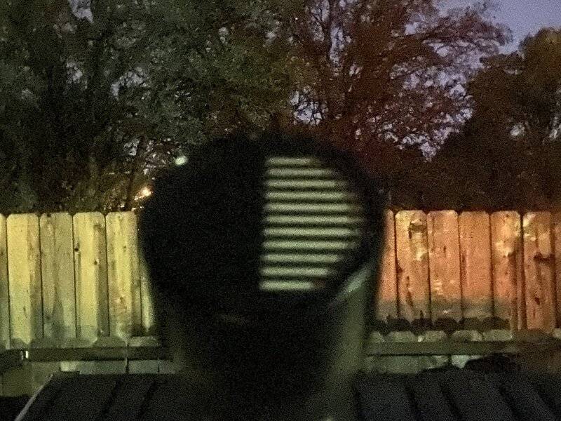

This diffraction / interference pattern was created by placing a window screen in front of the lens...
On the other hand, here is a laser passing through a pinhole (a pinhole which is equivalent to a telescope’s aperature), and we’re seeing no less than 27 orders of diffraction…
https://en.m.wikipedia.org/wiki/Airy_disk

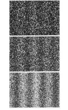

Also, due to shot noise, the diffraction pattern doesn't form from the inside out, but rather across the entire image frame, somewhat randomly...

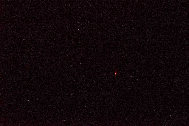

Suppose we have 3 different monochrome laser sources of varying intensity but the same wavelength shining through a diffraction grating and we take 3 exposures of consistent exposure length and consistent processing... Since the photons are discrete & arrive randomly, we end up with three diffraction patterns, all the same angular and pixel dimension size, but varying only in brightness...
^The three lasers were different brightnesses, exposure times were the same, and all the diffraction patterns ended up the same size with identical image processing...
I think you would agree that the spikes get progressively dimmer, the further out (that's what we find with diffraction). So, if every star in that image has detectable spikes extending to the edge, there must be stars available with images that are as bright as the dimmest end of the dimmest spike. @collinsmark seems to imply saying that those 'dimmest' stars will still have spikes going out to the edge? In which case, those are not the dimmest stars available. I really don't see how anyone can argue with that logic.
I don't understand how one can say that the single photon quantisation (a quantum efficiency of 100%) is the same as the smallest step of the sensor ADC. The photon energy corresponds to the range of the frequencies involved but the digital value is what it is.

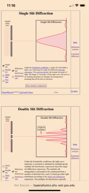

Not necessarily. Count 10 photons from a bright source that passes through a pin hole and only 2 from a dim source. Same exposure time and the sensor is an array of single photon counters.
Suppose the 10 photons from the bright source arrive by random chance within the 0th, 3rd, 5th and 6th diffraction orders.
The 2 photons from the dim source arrive by chance within the 8th and 12th diffraction orders. The dimmer source's spikes in this case are longer than the bright source's spikes.
http://hyperphysics.phy-astr.gsu.edu/hbase/phyopt/grating.html

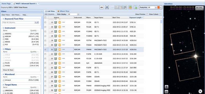

I'll try to help you understand how that works, using examples. I'll use JWST my first example, and my own camera as a second example:
JWST:
First, you can find the specs here:
https://jwst-docs.stsci.edu/jwst-ne...detector-overview/nircam-detector-performance
Note the "Gain (e-/ADU)" and the "Quantum efficiency (QE)" in Table 1.
As you can see, JWST uses two different gain settings, one for short wavelengths and another for long.
The Quantum Efficiency (QE) is naturally dependent on the wavelength.
So let's say that were presently using JWST's F405M filter, which is a long wavelength filter with a passband at 4 microns.
Going back to Table 1, we see that
Gain: 1.82 [e-/ADU]
QE: 90% [e-/photon]We can convert that to photons by dividing the two:
\frac{1.82 \ \mathrm{[e^- /ADU]}}{0.9 \ [e^- / \mathrm{photon}]} = 2.02 \ \mathrm{photons/ADU}
So for when JWST is using its F405M filter, it takes on average about 2 photons to trigger an ADU increment.

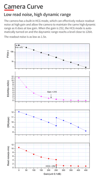

My Deep Sky Camera: ZWO ASI6200MM-Pro:
You can find the specs here:
https://astronomy-imaging-camera.com/product/asi6200mm-pro-mono
So, for example, if I'm using my Hydrogen-alpha (Hα) filter, which as a wavelength of 656.3 nm, we can see that the QE is about 60%.
But if I set my camera gain to 0, corresponding to around 0.8 [e-/ADU], that gives
\frac{0.8 \ \mathrm{[e^- /ADU]}}{0.6 \ [e^- / \mathrm{photon}]} = 1.33 \ \mathrm{photons/ADU}
So with this gain setting and when using the Hα filter, it takes on average about 1.33 photons to increment an ADU.
(I like to set my camera gain to something higher for better read noise, but I'll just use a gain setting of 0 here for the example.)
Had I instead set the gain setting to around 25, which corresponds to somewhere close to 0.6 [e-/ADU], that would correspond to roughly 1 photon/ADU on average.
That should be no surprise to anyone. That large image of many stars shows long spikes for many stars that are not actually near saturation but the fainter ones do not have identifiable spikes. When the absolute value of the spike pattern from a low intensity star falls below 1 increment then probability of it causing a hit gets less and less. I really don't see why this isn't obvious.

Here's a red diffraction pattern extending to the edge of the telescope's image circle:
Here's a blue diffraction pattern extending to the edge of the telescope's imaging circle:
Blue Channel:
Red Channel:
Here's both superimposed in the same viewing frame:
The center of the red diffraction pattern has an RGB value of 226,0,0 and the center of the blue diffraction pattern has an RGB value of 0,0,150... Which diffraction pattern is "larger?"

sophiecentaur said:
@collinsmark thanks for that information. It's interesting that the efficiency seems to be so high. However, isn't there something fundamental that means having gain too high will just increase the effect of shot noise wasting one bit of bit depth?
@sophiecentaur Yes, the gain setting does affect the noise, but it's a bit counterintuitive, and might not be what you think.
  • Firstly, it's mostly all a matter of read noise. I'll get to shot noise in a second, but read noise is affected more by the gain setting.
  • The read noise contribution is actually lower with higher gain, not the other way around. So if you want to lower your sensor's noise, and you're not at risk of saturation, increase the gain.
  • The gain value does little to nothing to the pixel detection or the electron well. It really doesn't make the sensor more "sensitive," as one might think. Rather, in most cases it merely affects the ADC operation, which is on the back-end of the pixel, not the front.
Yeah, I know, that might sound counterintuitive that increasing the gain lowers the noise. Especially if you're a typical photographer. This same thing applies to a DSLR camera. Higher ISO settings actually produce less noise, not more.
If you tell that to a photographer friend, they will yell back, "no way! When I take a photo with higher ISO it always comes back noisier!"
But what they're forgetting, is that when they increase the sensor gain, they naturally compensate by lowering the exposure: either reducing the exposure time (a.k.a., shutter speed), lower the aperture (a.k.a., f/stop), or both. Lowering the exposure reduces the number of photons accumulated, and that is what increases the noise: in the form of shot noise, since there's less signal. And for that matter, the signal to noise ratio (SNR) is reduced because, well, there's less signal. But this entire test is an apples-to-oranges comparison. Too many variables.
To make an apples-to-apples comparison, you need to lock down the exposure (f/stop and shutter speed) and compare pictures with only changing the gain setting (ISO). If you take a photo of a dim object (to avoid saturation even at high gain) and analyze the results with both gains, you'll find the one with high gain actually has the higher SNR!
Read noise vs. gain characteristics are typically nonlinear and vary quite a bit from camera model to camera model. Look at this plot showing the read noise vs. gain for my new planetary camera, ZWO ASI585MC. (Notice that it's different than the camera from my last post. These characteristics do vary quite a bit by camera model.
One thing that seems to be true in every camera I've ever seen is while although the read noise vs gain may be nonlinear, it's always decreasing monotonically: higher gain means lower read noise.
Yeah, if you're like me, this is difficult to wrap one's head around. I've created an analogy that might help.
Imagine that you keep a pile of marshmallows (representing electrons) in a silo (the well). And you have a measuring stick (the ADC) that coverts the physical height of the marshmallow pile to number (the output), representing the height.
A rabid badger (representing the source of read noise) is always grabbing the measuring stick and yanking it back and forth and all over, so it's difficult to get a steady reading off of the measuring stick.
Now here's the neat thing: You have the power change the size of the measuring stick and the rabid badger. Increasing the "gain" setting, has the effect of shrinking the measuring stick, and the badger gets smaller too, to some extent.
This however, has some ramifications:
  • By increasing the gain (and thus shrinking the measuring stick), the stick can no longer measure as high. The maximum height of the measuring stick is reduced. In other words, it's dynamic range (DR) is reduced.
  • Higher gain settings shrink the size of the rabid badger too! The smaller rabid badger doesn't do as much shaking in reference to the actual, physical height of the marshmallow stack. In other words, the important measure: the amount of shaking of the stick in units of marshmallow height, is reduced.
  • The noise of the output value (i.e., the final output number) might change with greater ADU numbers, but not relatively so. If you divide the standard deviation of the output number by the mean of the output number, you'll find the result is less when the gain setting is higher.
  • The size of the rabid badger does not necessarily shrink the same amount as the measuring stick. If you halve the size of the stick, you don't necessarily halve the size of the rabid badger, but it does get get smaller.
  • Notice that changing the gain setting really has nothing to do with the marshmallows, silo, or anything that comes before that.
Some of the increased read noise (at lower gain) might arguably be the result of higher quantization at lower gain settings (i.e., posterization). But I'm lead to believe that while posterization might play a role in explaining that, there is more to it.
Whatever the case, here's a word of advice: if you're far from saturation, and for what ever reason you don't want to or can't increase the exposure time, increase the gain instead to maximize SNR.
The colour images could be misleading because our sensitivity / perception of colours is a 'human quality. Personally, I can't see the blue fringes at all clearly on my phone. An astrophotographer, using a monochrome camera would be better placed to come to a meaningful conclusion. If the monochrome images do not follow the maths then there's something wrong, once they've been normalised. If there's a ratio, of two in the wavelengths then there should be a factor of two in the spacing (for small angles, at least).
  • #86
Devin-M said:
Blue Red Channel:
Red Channel:
Assume they both go all the way to the edge but the same color. One is dimmer, which is “larger?”

Here's some proof light can diffract across an entire sensor on the JWST...
Or even 2 sensors...

Devin-M said:
which is “larger?”
Sorry, I don't get where you are coming from. If they both 'go to the edge' then the edge defines their extent. What does this demonstrate?
The theoretical curve never goes to zero.
The word "proof" implies that there is some doubt. You notice the star centre is well burnt out; there is no limit to how far out the spike could go. The (reflecting) struts supporting the reflector are the long line sources and the pattern from a line will be of the form (sin(x)/x)2 in the direction normal to the strut. Their reflecting area is pretty significant. The envelope falls off as 1/x2, which takes a lot of peaks before it starts to disappear.

Followup question. Above I’ve taken the same image of the same star and split the image into just the red light (red channel) on the left and just the blue light (blue channel) on the right. We can see the apparent position of the dimmer stars with no visible diffraction spikes are the same in both images (bottom left, top right, and the one just below the right side diffraction spike), but the points of maximum brightness of the diffraction spikes are in different positions depending on color.
Does it mean that only photons of the same color/ wavelength interfere with each other?
For example suppose I use a red monochrome laser as a point source viewed through my aperture, and note the distances of the maxima from the apparent source. Next I aim at a star (broadband) and take an exposure sufficiently long to see the same number of maxima, and look at the red channel. Will the red spots be same distance from the apparent position in both cases, even though in the star/broadband case there are additional wavelengths of light traveling through the aperature? Will the blue wavelengths for example change the apparent positions of the red interference maxima?
