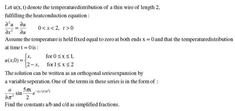

Since the problem involved formulas I have posted it as an attachment. Please check the attachment first. (I have not scanned this problem, just wrote it in word and posted it)
My approach on this problem is to start with separation of variables as I don't see any indication that tells me that I am dealing with non homogeneous conditions and can't separate. I am thinking that in order to get u, I need to separate for sure. Can anyone verify if that seems as a reasonable approach to this problem?

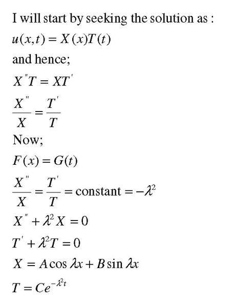

I will post my initial approach as an attachment. Do I apply the boundary conditions while I have solved for u?

You separated variables and determined that the "parts" of the solution are [itex]X(x)= A cos(\lambda x)+ B sin(\lambda x)[/itex] and [/quote]T(t)= Ce^{-\lambda^2 t}.
Now you can use the boundary conditions, that u(0)= 0 and u(2)= 0, which tell you that X(0)= 0 and X(2)= 0, to determine what values [itex]\lambda[/itex] can have (so that [itex]sin(2\lambda)= 0[/itex]) as well as the fact that the coefficients of [itex]cos(\lamda x)[/itex] are all 0 (so that X(0)= 0).
Since the exponential will be 1 at t= 0, You can write the initial conditions in terms of a Fourier sine series.
Since you are told that one of the terms in the expansion is of the form
[tex]\frac{a}{b\pi^2}sin(\frac{5\pi x}{2}e^(-(c/d)\pi^2t}[/tex]

[tex]\frac{a}{b\pi^2}sin(\frac{5\pi x}{2}e^(-(c/d)\pi^2t}[/QUOTE]<br /> <br /> Thank you for trying to help me. I have tried a lil bit but I got confused so I guess I want to make sure that what I am doing is correct. <br /> <br /> X(x)=A*cos(lambda*x)+B*sin(lambda*x)<br /> X(x=0)=A*cos(0)+B*sin(0)=>A=0<br /> X(x=2)=0=>B*sin(2*lambda)=0<br /> <br /> Lambda=((n*Pi)/L)^2<br /> so the eigenfunction EF, EF=B*sin((n*Pi)/L)^2<br /> <br /> How will I move on from here?[/tex]
I know that I need to consider temporal and special separately. For the spatial do I have to consider Lambda=0, Lambda<0. Lambda>0 cases?

One's solution seems correct.
One has used the boundary (spatial) conditions to eliminate the cos function and determine the eigenvalue [itex]\lambda[/itex]. One will note that sin (n[itex]\pi[/itex]) = 0, n is an integer = 0, 1, . . . . infty.
Actually, the spatial function X(x) will be written as an infinite series of sin terms, and each will have a coefficient, Bn. Has one learned how to determine the coefficients?
From the images:
[tex]\frac{a}{b\pi^2}sin{\frac{5\pi{x}}{2}}e^{-\frac{c}{d}{\pi^2}t}[/tex]
[tex]X(x) = A cos {\lambda x} + B sin {\lambda x} = B sin {\lambda x}[/tex]
[tex]T = C e^{-\lambda^2t}[/tex]
then
[tex]X(x) T(t) = C'_n sin\,{\lambda x}\,e^{-\lambda^2{t}}[/tex] and compare to the above expression
