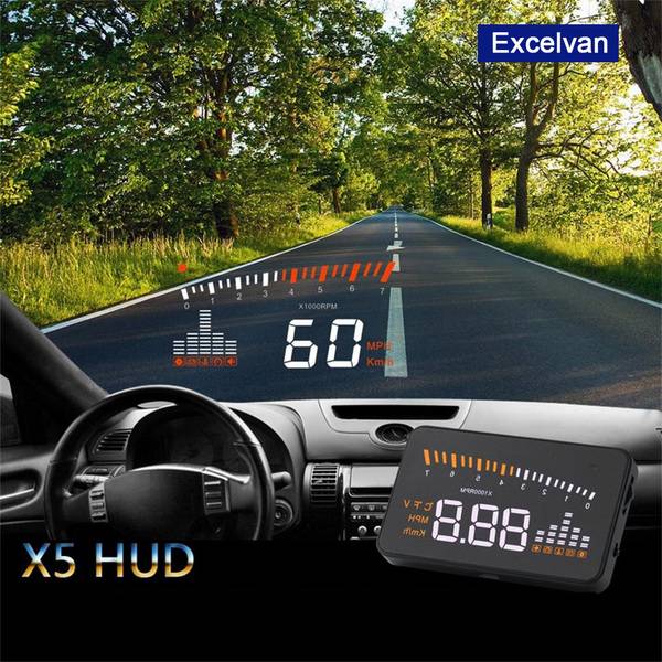

Did you read the Wikipedia link on Head-Up Displays that @jedishrfu posted. The glass just partially reflects the image toward your eyes, so even regular glass works. There are probably some glass materials that work better for the function, but it is the HUD configuration and design that makes it work as a display, not the glass surface itself.
Please do some of the suggested reading, and if you still have specific questions about that reading, ask here and post links to your reading. Thanks.
https://cdn01.ovonni.com/uploads/2015/201510/20151027/heditor/201510271455574036.jpg
Promotional photo of the X5 HUD unit mounted on a car dashboard, projecting speed of 60 MPH/Km/h, an RPM bar graph and a digital readout onto a sunlit tree-lined road ahead.
  • Promotional photo of the X5 HUD unit mounted on a car dashboard, projecting speed of 60 MPH/Km/h, an RPM bar graph and a digital readout onto a sunlit tree-lined road ahead.
Why is the 888 display backwards?
LOL, good question. :smile:
They have some other "artist rendering" errors at their website, but I think what they are trying to show is what the display looks like before you install it on your dashboard. If you were sitting on the hood of the car looking down at the display on the dashboard in front of the steering wheel, I believe that is what the display itself would look like (not the projected image).
