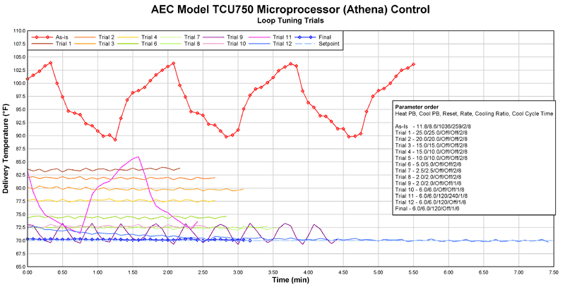

Consider a TCU (Temperature Control Unit) consisting of a centrifugal pump, 12 kW resistance heater, and a cooling solenoid connected to a 50°F chilled water source for 'direct injection' cooling. In temperature trending below, 'As-Is' loop tuning had the output slamming 'rail-to-rail' between 100% heating, and 100% cooling with temperature oscillating between 90°F to 104°F (14°F peak-to-peak variation) for a 70°F setpoint. After 'final' tuning, output remained between 30% cooling to 40% cooling providing a process temperature ranging between 69.6°F to 70.4°F (0.8°F peak-to-peak variation).
This controller has somewhat peculiar parameters including a separate term for cooling proportional gain (typically, commercial temperature controllers have a heating prop gain, and a multiplier term derived from it for cooling prop gain) and a 'Cooling Ratio' term that, as it turned out, was a range matching scheme so anything from chilled water to hot oil cooling sources could be used. 'Reset' and 'Rate' are scaled in seconds, and are an older terminology used to denote integrating and derivative gains. At the time I didn't have a copy of the manual, and was conducting multiple trials using different tuning parameters to better understand how they worked. Data collection for this trend continued to the end of my work shift. The 'final' reset (integrating) time of 120 seconds shown in the table is too high (note how long 'trial 12' temperature took to converge to setpoint), and was touched up the next day to 40 seconds.
My interest then was to minimize temperature swing, and I was collecting data by scrawling it into a notebook every 5 seconds so didn't bother (nor had time) to collect % output information. The 'humpedness' of 'As-Is' temperature variation suggests cooling on-time % wasn't symmetrical with heating % (it was probably more like 30% cooling/70% heating rather than 50%/50%), but for the purpose of cost estimation let's pretend it was a 50:50 split.
Energy cost for a 12 kW heater at $0.10 USD/hour is $1.20/hour at 100% heating. It is difficult to estimate an accurate value for cooling, what with cooling tower and process pump and chiller compressor energy, maintenance, makeup water, treatment chemical, and other costs, but a kWh of chilled water cooling ends up costing more than a kWh of electric heating. For now, let's guess $1.50 an hour for cooling.
An hour of 'As-Is' temperature control operation at 50% heating/50% cooling would be (0.5*$1.20)+(0.5*$1.50), or $1.35 an hour. After tuning, output no longer traversed into the heating side, and averaged 35% cooling (0.35*$1.50), or about $0.53 an hour.
In this case, improper loop tuning cost approximately $0.82 extra per operating hour.

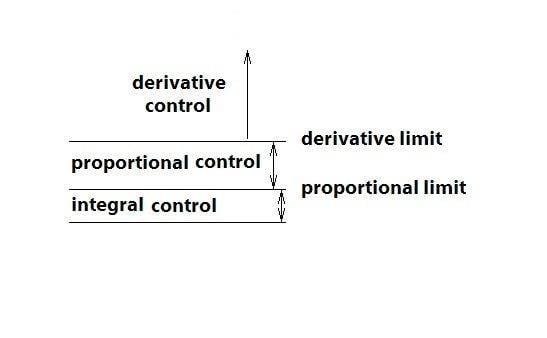

Stability in PID control can be augmented with dead-bands/limits.

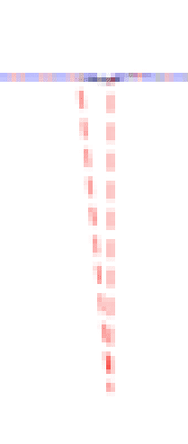

@jim hardy @Asymptotic Thanks for your replies. From some research and simulation analysis, i found the following information. "Increasing a forward path gain will increase controller output voltage and current and will try to accelerate the plant at a higher rate; the response will be faster so viscous friction will increase, also amplifier saturation will cause nonlinear effects." So what is your opinion about this??

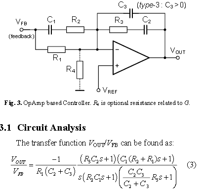

It could instead be referring to outputs from op amps forming an analog computer purpose-built to solve PID equations, although these days nearly all commercially available PID controllers are digital. Bottom line - increasing proportional gain increases output.@Asymptotic Actually, i am talking about the controller itself, i simulated and found that when the gains increase the noise in the output waveform of the controller also increase the waveform amplitude increases too.

Can you capture and upload this waveform?
It sounds like you are describing steady oscillation caused by excessively high proportional gain (or, from the reciprocal perspective, a too narrow proportional band), and/or the loop has too much integration and/or derivative. The Ziegler-Nichols tuning heuristic can be useful. In a nutshell, turn off I and D, take note of the oscillation period, and adjust P gain to just under the value where oscillation stops. Adjust I and D parameters as suggested by the Ziegler-Nichols method, then (if necessary) tweak the PID parameters to achieve whatever response curve suits your needs, for instance, quarter damped response.

Yes the controllers i used were op-amp based. Most were electronic
Here's a clever one that uses a single amplifier, devised back in the 40's when opamps were something exotic .
https://pdfs.semanticscholar.org/15ea/514e8e45966c99b0a3a0b7fb873c0ecf0400.pdf
Since it has integral(reset) a limiter on Vout would be prudent.

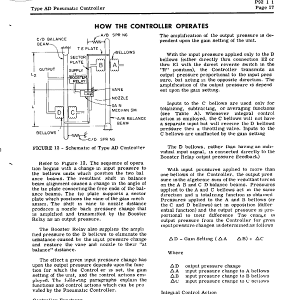

Some were pneumatic running on compressed air 3 to 15 or 3 to 27 psi. An orifice is a resistor and a volume chamber is a capacitor. They sum forces instead of currents.
Wow- here's an instruction manual for one . I didnt expect to find that.
The vane-nozzle is your null detector, and the booster relay is your opamp with gain of perhaps fifty.
http://www.infi90.com/Files/Bailey Infi90 Documentation/Mini-Line 500 Controller Type AD.pdf

Abdul Wali said:
@Asymptotic https://drive.google.com/open?id=0B9NQhKDld_D4SzZuN2xUZ2RXRlU output of pid
Is there any way to plot deviation separate from output (or is there an option for a second Y scale)? The Y axis is scaled +1*105 to -1*105, what appears to be the output signal swings from +80% to -80%, and this corresponds with a small perturbation in the blue line which I'm taking to be deviation from setpoint. In any event, if these output swings are what the PID loop is coming up with to maintain setpoint, it looks like proportional gain is too high by quite a bit.
Never played with pneumatic PID loop controllers, but have fondly frightening memories of pneumatic logic controllers before electronic PLCs took over. Remember how timing relay setpoints were tuned by cutting nylon tubing coils to various lengths? Once a newbie decided to 'clean up' the resulting rat's nest ... it took days to get the machine back into operation ;).

At 500% i can't tell which moves first

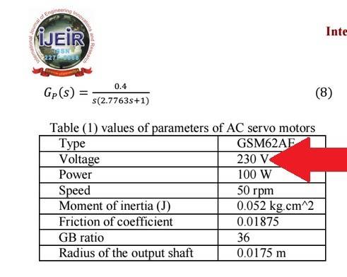

I don't think you can consider loop output to be voltage. 0.8 *105 is 80,000, and a controller output of 80 kV wouldn't make sense.
@Asymptotic on page 277 of the attached article look at the equation 7 and then on page 279 look at the Simulink model, from the equation it can be clearly seen that the E(s) is the input to the motor or output of the controller. but yeah it is E(s) not E(t). but still voltage. https://drive.google.com/open?id=0B9NQhKDld_D4WG1KSVBJWnA3eW8 Now what do you think? @jim hardy

I think with 230 volt supply it's hard to make 80 kilovolts
and even if you did you'd wreck your servomotors
from that article, page 278

@jim hardy as in the article he is comparing PID and IMC, so normally if u see the waveforms IMC response is better than PID but when i tune pid to the level where its response is even better than PID than the 80kv happens. else in normal condition, when the pid response is same as shown in the paper, this does not happen.

A 230V motor winding insulation system would punch through within microseconds with 80,000 volts applied. I'm not conversant with MATLAB and Simulink, but for it to allow 80kV as a legitimate value suggests the model has no means to flag physically unrealizable answers.
Actual servo positioning controllers have a 'following error' parameter used to trip the servo drive amplifier (to save it from an untimely death) if error between commanded and actual position rises beyond a certain point. One of the several common causes of following errors is too high a ramp rate, and attempting to accelerate the driven system faster than the drive/motor can provide power for.
